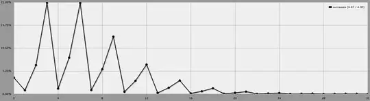

FWIW, this is what the output of the code above looks like in Graph mode:
AnyDice screenshot

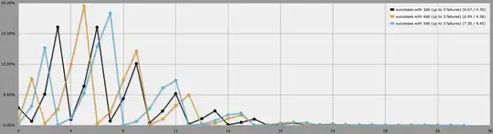

That's an interesting looking graph! I wonder where those peaks at multiples of three successes come from. Let's see what happens if I adjust the maximum allowed number of failures while keeping the pool size fixed:
AnyDice screenshot

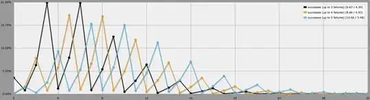

And here's what happens if I adjust the pool size instead:
AnyDice screenshot
It looks like the spacing between the peaks is determined by the pool size, but the position of the peaks is also affected by the maximum number of failures — apparently allowing one more failure moves the peaks one success to the left.

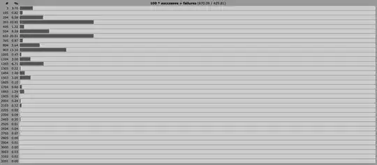

As long as F can never be greater than 99, this encoding is unambiguous and easy to read: the last two digits of the encoded number correspond to F, and the digits to the left of them to S. So, for example, the output 603 corresponds to 6 successes and 3 failures.
Alas, the one feature we lose is the ability to (usefully) graph the output. But we can still look at the output in Table mode:
AnyDice screenshot
In particular, looking at this output and playing with different maximum failure counts and dice pool sizes, we can see what's going on with the peaks: the total sum of failures and successes must, of course, be a multiple of the pool size, and the peaks simply correspond to the cases where we roll the minimum number of failures needed to stop, as that's more likely than overshooting.
