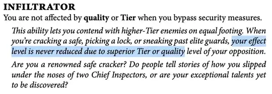

The Lurk's special ability reads:
Infiltrator
You are not affected by quality or Tier when you bypass security measures.
Does this mean that the Lurk's Fine Lockpicks item also has no effect for a character with this special ability?

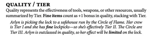

Fine lockpicks: A finely crafted set of tools to disable and circumvent locks. [0 load]
Fine items count as +1 bonus in quality, stacking with Tier.

The explication of this ability further clarifies that the PC should not be hindered by opposing quality/tier insofar as it specifies that they "never [reduce]" effect level. infiltrator

If you want to dive into the details a bit in order to make a case to your fellow players, consider the following: Firstly, Infiltrator should only negate any disadvantages (viz. #1) to the PC from being "outclassed" in quality or tier. Secondly, there is a general, here tacit, understanding that the infiltrating PC will make an action roll, and that the action roll follows a procedure. Long story short, at some point in that procedure, the GM announces position and effect, using a set of criteria to evaluate "effect factors". One of these effect factors is Quality/Tier. Quality/Tier
Here we see an example situation, moreover one with Fine lockpics! Notably, this example demonstrates the expected result, but neglects to demonstrate the procedure to get there. Properly, a player can suggest that they want to make an action roll for their PC, before choosing any modifying factors like Fine items. After the GM announces the position/effect level, the player can elect to use a Fine item to their advantage, thereby improving position or effect. In other words, position and effect are much more dynamic and contingent on circumstances than the above example suggests. C.f. TRADING POSITION FOR EFFECT
After factors are considered and the GM has announced the effect level, a player might want to trade position for effect, or vice versa. ...
This kind of trade-off isn’t included in the effect factors because it’s not an element the GM should assess when setting the effect level. ...
(emphasis mine)
The "effect factors" Potency, Quality/Tier, and Scale determine the position and effect level. Reasonably, Infiltrator's
might be construed to refer to these same initial "effect factors"--namely, those established before any modifications are added or trades are made for position. On this interpretation, the GM would still announce the position/effect as e.g. "Risky/Standard", despite ignoring quality/tier, because scale and potency will still affect position and effect level. At this point, a player ought to be able improve their PC's position with Fine lockpics.

Your own quality and tier are part of you; they don't affect you.
Or maybe a better way of phrasing the ability is "you are not affected by quality and Tier when bypassing security measures if you don't want to be." The clarification text makes it pretty clear what's going on here:
This ability lets you contend with higher-Tier enemies on equal footing. When you're cracking a safe, picking a lock, or sneaking past elite guards, your effect level is never reduced due to superior Tier or quality level of your opposition.
-- Blades in the Dark, "Playbook: Lurk", p. 74, emphasis mine
If it was supposed to be a double-edged sword, such that your own superior Tier or set of fine lockpicks wouldn't increase your effect level either, the text would say so.
So, a Lurk with this ability and an applicable set of fine lockpicks is always operating at least one effect level higher due to quality and tier effects, regardless of whose lock they're picking or how fine it is.
