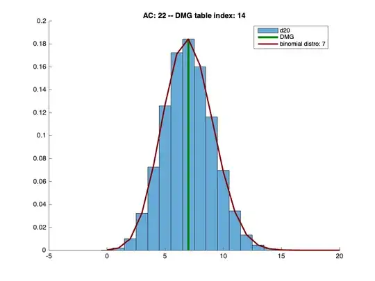

Another way to see it is looking at the binomial distribution, which counts the number of success on independent trials, when the probability of success is the same. The figure below shows the simulation of 100 000 scenarios of 20 attackers, against an AC of 22 and with an attack Bonus of +8. Plotted against this simulation, the solid line represents the binomial distribution, and the legend reports the expected value using such distribution. The green line refers to the number of successful hits given by the method presented in the DMG.
Histogram of simulation, plot of the binomial pdf and number suggested by the DMG
The table reported in the DMG is a rough approximation: a more accurate one should be the table below.

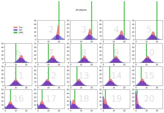

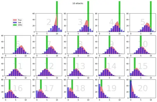

How good is this approximation?
Thanks to @Eddymage for the plot idea.
20 attacks
10 attacks
The big number in each subplot is the number needed to-hit.
The red area shows the true distribution of the number of hits (counting crits as one); the blue bars are the results of this margin-of-success method. As long as the chance to hit is not too far from 50%, the approximation is decently close. 5e's doctrine of bounded accuracy means that this should be the case most of the time.
The green bar in each plot is the DMG method, which is deterministic, making it a degenerate distribution with zero standard deviation. Thus, it has just one skyscraper of a bar that goes to 100%. I've let it overflow the plot on the first row.

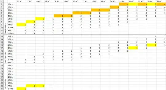

This is untenable to perfectly model.
If you look at the number of possible results from rolling 10d20, you get:
$$C^R(20,10) = \frac{(n+r-1)!}{r! * (n-1)!} = 20,030,010$$
Mapping 20 million results to a single d20 roll is clearly not possible especially when some of the results are as few as 1 in 20 million odds.

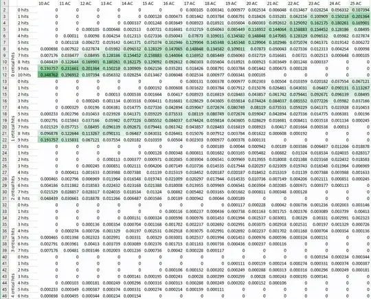

Starting with outcomes rather than discrete results

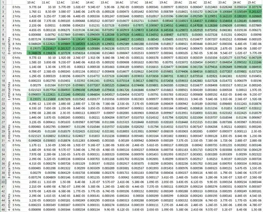

To start with tackling the problem, we should boil it down to misses, hits, and critical hits. These probabilities will be different for each AC, so we will have different distributions as a result. Below is what you get for 10-25 AC. You'll see why I cut off 5 critical hits and greater in the next section.
As you can see, for high and low ACs, the probable results are extremely concentrated on a handful of outcomes whereas middling ACs are more widespread.
Regardless, in either case, a large number of outcomes are extremely unlikely. By pruning unlikely outcomes we may be able to actual develop some mappings.
Pruning unlikely outcomes
Where you draw the line at "unlikely" is arbitrary, but I chose to use 1 in 10,000. Over the course of a year long campaign, you will probably only be making around 500 animate objects attacks at most (assuming 2 combat encounters per session, 2-3 rounds per encounter, and 50 sessions).
As such, we can demonstrate the unlikeliness of these outcomes using 54 in 10,000 (for a maximum of 54 possible outcomes with these low percentages) with 500 attempts. This yields:
$$\frac{500 \text{ attempts}}{\frac{10,000}{54} \text{ attempts per occurrence}} = 2.7 \text{ expected occurrences}$$
If you are willing to sacrifice less than 3 dramatic results (which could be positive or negative) over the course of an entire campaign, we can prune out these results and get the following distribution (adjusting probabilities to account for the loss of some sections):
Many critical hits
The first step was to deal with the feasible but still relatively unlikely situation of more than a couple critical hits. To deal with this, I propose a new rule:
If you roll a natural 20 using the model, you can roll d20s to turn some of the normal hits that you gained into critical hits. This happens on another roll of 20, and continues until you stop rolling 20s.
This allows for those scenarios with similar odds and also makes the natural-20 with animate objects that much more exciting.
We can then remove the 3-critical hits and 4-critical hits sections, as well as the bulk of the 2-critical hits section to more easily fit the remaining options onto a single d20.

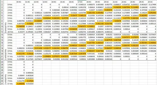

Combining similar outcomes
We still have some outcomes with less than a 1 in 20 chance which are difficult to map to a single d20 roll. In order to resolve this, I shunted them to the nearest result that was very close to an interval of X in 20.
Here I highlighted those sections where yellow represents the shunted probabilities and orange represents the destination (adjusting probabilities to account for the loss of some sections):
This gives the following distribution with probabilities all in the ball park of intervals of X in 20. Thus, we can follow these steps to get our models:
  • Multiply each cell by 20
  • Round to the nearest whole number
  • Add values on the low-end to create 20 total outcomes for each AC (highlighted in orange)
  • Make some judgment-based adjustments to account for the shunting (highlighted in yellow)
Doing this we get the following models:

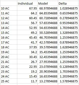

Expected damage
To evaluate these models for their efficacy, I calculated the effective damage of rolling separately or using the model. Remember also that any 20s continue to roll for additional critical hits.
Here is the result:
As you can see, our models slightly overestimates our damage output (and no, it isn't just because of the natural-20 rule). I'm not 100% sure where this variance comes from and I even used the 20-total-outcomes and rounding-adjustments to try to reign in this variance.
Regardless, these models should work fairly effectively with an average variance of only +1.2 points of damage. You could always make slight adjustments to bring this in line, but those adjustments would be arbitrary just as mine were. I couldn't figure anything else obvious to adjust with any justification.
Ordering the models
From here, we just need to place the models in order so that the intuitive paradigm that rolling higher is better is preserved. To do this, simply match up the number of hits and place the critical hits higher.
Here is how that is done for AC 12:
Conclusion
Overall, modeling this many results on a single d20 roll is just not a good idea. Even filtering down and adding arbitrary adjustments with any sort of justification (such as rounding differences, average position of shunting, and removal of permutations), I couldn't conveniently fit my models to the expected outcomes of rolling individually, let alone the distribution of outcomes (which isn't particularly accurately modeled at all).
I would suggest using the proposed rules in the Dungeon Master's Guide as in Eddymage's answer.

We can calculate the distribution of possible hits, and map those to dice. First, we use the attack bonus (+8) and AC (17) to calculate the accuracy (55%). Then, for each of the 20 possible die rolls representing the result with the odds 2.5%, 7.5%, 12.5%... 92.5%, 97.5%, we calculate the number of hits.
It turns out this is tricky to do in one step, so its easiest to do in two steps. First, for each number of hits, what are the odds of at least this many hits occurring? This can be calculated in Google sheets with the equation BINOMDIST(NumberOfHits,NumberOfAttackRolls,HitChance,true) For an attack bonus of +8 against an AC of 17, and 10 attacks, that generates this table

We can also calculated the expected number of crits via the same formula, with "a 5% chance to hit".
I have made this spreadsheet to calculate all of this, and also average damage. If you don't want to have a sheet open to adjust the AC for each target, then can consider saving the results for each possible AC.

I like Eddymage's answer. This is based on that. If I was allowed, I would comment this as a suggested improvement to that answer.
If you want to make the result on the DMG table be based on an attack roll, you should flip it and subtract 10 like so: 20 -> 1 -> -9, 18 -> 3 -> -7, 10 -> 11 -> 1, etc
