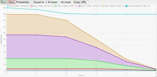

Here's a script using my Icepool Python library:
from icepool import Die
die = Die({ (0, 0, 1) : 1, # 1: bad (0, 0, 0) : 2, # 2-3: nothing (1, 0, 0) : 2, # 4-5: success (1, 1, 0) : 1, # 6: trigger })
extra = Die({ (1, 0, 0) : 1, # success })
def score(successes, triggers, bads): return successes, min(triggers, 4), bads > successes
def degenesis(n): raw = min(n, 12) @ die + max(n - 12, 0) @ extra result = raw.map(score) print(result) for triggers in [4, 3, 2, 1, 0]: area(result.map(lambda s, t, b: s if t >= triggers and not b else -1), f'{n} dice: +{triggers}') output(result.map(lambda s, t, b: s if b else 100), f'{n} dice: clean')
limit(0, 5) degenesis(5)
Example graph.
The dice have vector values, represented by tuples (4+s, 6s, 1s). The @ operator means roll the right side a number of times equal to the left side, and add them up. Then the map method is used to convert the raw result to what we want to know.
This computes the full joint distribution of (successes, degree, may_botch), which is stored in result. Then it plots the chance of getting at least 0...4 degree while also reaching at least a given degree of success, with the difficulty achieved on the x-axis. It also plots the chance of getting a "clean" roll (no botch if failed).

  • A CDF might be of more use to visualize this; the chance of 4+ success, 3+ success, 2+ success, 1+ success, 0+ success, failure-or-better, and 100% (aka, crit-fail or better). – Yakk Mar 03 '23 at 14:48
  • But then we'd have to input each difficulty separately. Perhaps the solution for joint distributions is another type of graph, such as a treemap. – HighDiceRoller Mar 04 '23 at 04:39
  • After some more thought, I see more of what you're saying. Though it will require plots that sum to less than 100%, which will in turn require some careful API design as a general feature. – HighDiceRoller Mar 05 '23 at 03:38

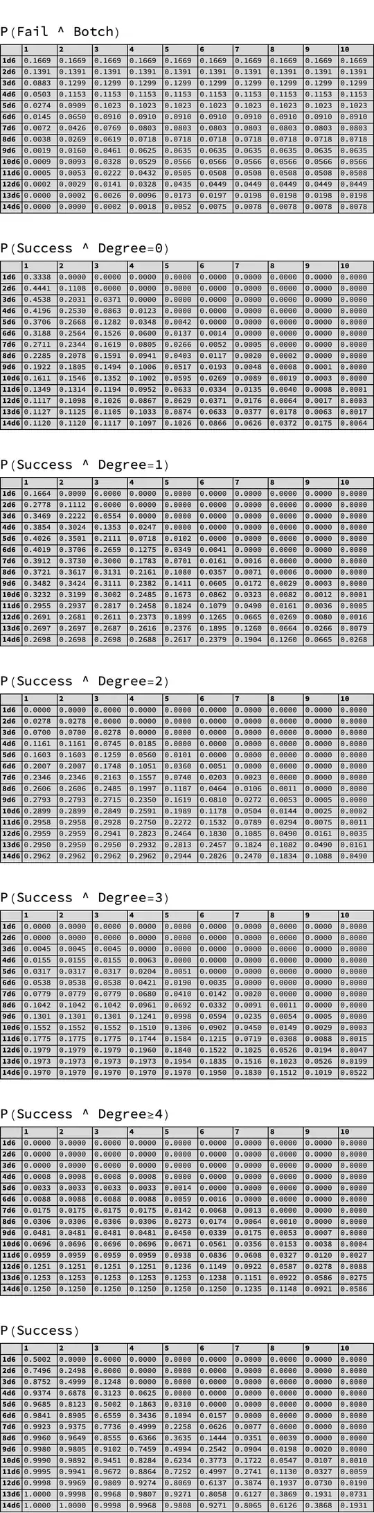

We can then build up a table of probabilities for each dice-count between 1 and 14 and for each difficulty between 1 and 10:
table = Table[
   With[
    {scores = N@Score@Roll[ndice]},
    With[
     {n = Length[scores[[1]]],
      nSucc = scores[[1]],
      nOnes = scores[[2]],
      nSixes = scores[[3]]},
     Table[
      With[
       {success = Unitize[Sign[nSucc - diff] + 1],
        botch = 1 - Unitize[Sign[nOnes - nSucc] - 1]},
       Table[
        (1/n)*Which[
          lev === None,(*Botches*)
          Total[(1 - success)*botch],
          lev === All,(*Any success*)
          Total[success],
          lev == 4,(*4 or more*)
          Total[success*Unitize[Sign[nSixes - 4] + 1]],
          True,(*A specific level of success ()*)
          Total[success*(1 - Unitize@Sign[nSixes - lev])]],
        {lev, {None, 0, 1, 2, 3, 4, All}}]],
      {diff, 1, 10}]]],
   {ndice, 1, 14}];
Here are the tables; each cell in the table gives the probability of success for the given difficulty (by column) and the given number of dice rolled (by row).

  • I did it in a google sheet with public access, but both for dead-linkage and for explanation, I went ahead and explained the code. Should probably include a picture of it, but I hate doing image editting :). – Alan Mar 03 '23 at 02:14
  • Simulation is a great idea! This is a great contribution. The only thing that jumps out to me atm is the botch rule-- a botch only takes place if an action was failed, therefore should it also empirically vary to some extent based on the difficulty? – ThetaHanse Mar 03 '23 at 03:16
  • Aha! I misunderstood that about the rules (I counted a botch whenever the 1s was greater than the successes). I'll edit the simulation. Anything else you notice? – nben Mar 03 '23 at 03:19
  • How can you have 1 success with degree 2 on 2d6? Surely if you have degree 2 then you have two 6s and will, by definition always have 2 successes. – MT0 Mar 03 '23 at 14:23
  • @MT0 I think you are misreading the chart? The 1 in the top row indicates that the difficulty is 1, so you can roll 2 6s, which meets the difficulty requirement of rolling at least 1 value > 3. – nben Mar 03 '23 at 15:28
