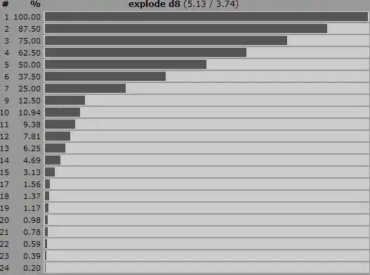

However, what is more important to your question, this system does have a chance to reach some rather high single hit damage levels -- as you say, theoretically unlimited high, but in exchange also being unlimited unlikely. In practical terms you can use these functions on anydice to see how likely it is to get an extreme outcome on a single hit, setting the output table to "at least":
output [explode d6] named "explode d6"
output [explode d8] named "explode d8"
output [explode d10] named "explode d10"
output [explode d12] named "explode d12"
And below is the output for a d8, for example
As you can see, the probability for exploding 3 times, for at least 25 points of damage, is about 0.2% here, and the higher values are not shown.
Much like with normal criticals, this is especially deadly at lower levels, as you do not need a lot of consecutive explosions to take the characters out. Even with some light Constitution bonus, typical characters maybe have around 10 hp on the first level, 16-17 on the second level, 24-25 on the third level, and 32-33 on the fourth level.
That means a d8 hit would have a 0.2% chance to outright drop a character of level 1-3. If you move up to a d12, you have a 0.23% chance to deal 33 or more, dropping a character up to level 4.
