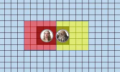

There is a way to reconcile this, at least for 2 characters fighting
First off, landing the carpet may not be an option. If you are flying high, say at 500 feet, when you are attacked, then the speed of the carpet will not allow you to get to the ground, you still would be over 200 feet up even after a full movement and Dash, and everyone who would have to clear out would face a potentially lethal drop.
However, the rules for space in combat under Creature Size (p. 191 PHB) say:
Each creature takes up a different amount of space. The Size Categories table shows how much space a creature of a particular size controls in combat. (...)
[A table showing the space is 5 feet x 5 feet for Medium or Small creatures]
A creature's space is the area in feet that it effectively controls in combat, not an expression of its physical dimensions. (...) A creature’s space also reflects the area it needs to fight effectively. For that reason, there’s a limit to the number of creatures that can surround another creature in combat.
This defintion does not state that the creature needs to be in the center of the space it controls. And there are no secret rules. If there is no rule that states the creature needs to be in the center, then it does not need to be in the center.
So for the smallest carpet, the following setup for two medium or small creatures could work:
Each square is 1x1 foot. The dark square in the picture is the carpet, sized 3x5 feet. The colored areas (yellow and red) are the spaces the two creatures control. Maybe they are fighting back to back.
The requirement that the creature needs five feet square area to "fight effectively" may need a bit of DM adjudication about if the limitiation to moving in only part of the controlled space would impose Disadvantage or not. We often play on dungeon maps where a character does not have a full 5x5 feet to occupy, but if it is more than half, would not apply the "squeezing" penalty. Here, each character has less than half the full square to maneuver so the DM could reasonable impose Disadvantage.
Nobody the Hobgoblin
  • 112,387
  • 326
  • 684
    By saying that the creature doesn't have to be in the center of the space it controls, you're literally saying that a creature can willingly choose not to control anything to the left (and/or right, and/or in front, and/or behind) of it or order to extend their reach in an opposite direction. That is like a goalie in soccer standing directly next to one side of a goal and thinking they can now leap farther to still protect the center of the goal. Regardless of where they stand, they can only dive the same distance left and right. There is no being "off center" in the space you control. – MivaScott Dec 01 '22 at 22:44
