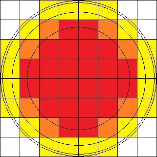

Airburst templates for a 20' burst
For a 20' burst, this is what it would look like on the ground if you burst at 15' (red), 10' (orange), or 0-5' (yellow; airbursting at 5' is the same as bursting at 0').
Fireball floor diagrams at variable burst heights

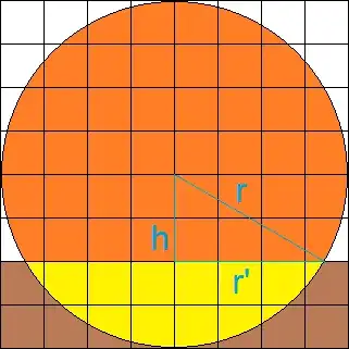

Hitting a character on the ground cares about the radius at ground level, per the DMG. You can calculate the floor-level circle's radius (r') with the radius of the initial burst (r, 20' in this case) and the height of the airburst (h). Viewed from the side (brown is ground):
Side view of a fireball at a 10' burst height
This gives us a right triangle, for which we can solve for the ground-imposed radius via
$$ h^2 + r'^2 = r^2\\ r' = \sqrt{r^2 - h^2} $$

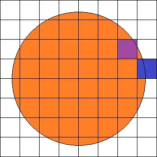

If the center of a square is in the radius, generally at least half of the square will be in the radius. You can calculate the center of a square by adding 2.5' to the corner-to-nearest-corner distance, so if we have Purple and Blue as potential targets of a 20' burst, airbursted at 10' for a 17.3' ground radius:
Two characters bordering a burst
Purple is over two and up one, so their center is at [10 + 2.5, 5 + 2.5]. Blue is over three and up zero, so their center is at [15 + 2.5, 0 + 2.5]. Their distances from the center can be calculated with the quadratic formula:
$$ purpleDistance = \sqrt{12.5^2+7.5^2} \approx 14.6\\ blueDistance = \sqrt{17.5^2+2.5^2} \approx 17.7 $$
Purple's center is in the radius so they are affected; blue's center is not so they aren't. As I noted, this is only generally true. The edgecases are pretty rare, but they are possible: airbursting a fireball at 15.5' has edge squares where the center of the square is in the radius, but less than half of the square is covered by the effect. To calculate that, you can integrate along the circle (which also is easier for prefab templates; WolframAlpha will do the heavy lifting for you).

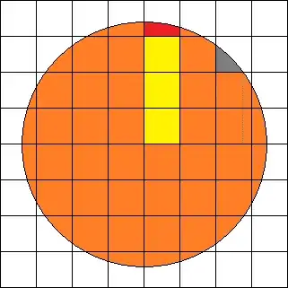

Now that you have some circles of non-standard sizes, you need to calculate which squares actually get included. Take a burst, viewed from above, with doubt for some of the periphery squares, namely the red one up top (this is just a 20' ground radius), treating the center of the burst as \$x = y = 0\$:
Diagrammed top-down view of a fireball

The full area of a circle that size is ~1256.64, or double what we calculated for the semicircle, as expected. What we're really looking for here is just the "extra" bit on a vertical strip: the last square (the red part). This formula gets more complicated for certain parts, but it works for the squares you're looking for, since the circle intersects both vertical edges of a single square.
For those specific edge squares, we're working with
$$\int_{5}^{10} 20 * sin(acos(x/20) \approx 92.37$$
We then need to subtract out the three full squares (5' x 15' = 75 sqft, the yellow part), yielding 17.37 sqft, or over half a square. Due to rotational symmetry this also applies to the horizontal parts, flipping around some operations.

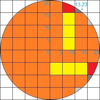

If you wanted to measure the dark grey areas (although they're clearly small enough to be visually discarded), you'd use the same formula, but would need to calculate the offsets. For the darker grey area, we need to find x when y = 15, which is just a simple
$$x = \sqrt{r^2 - y^2} = \sqrt{20^2 - 15^2} = \sqrt{400 - 225} \approx 13.23$$
We can then use the same integral:
$$\int_{10}^{13.23} 20 * sin(acos(x/20) \approx 52.46$$
Here we subtract partial squares ("rectangles" have not been invented yet) comprising 3.23' x 15' = 48.45 sqft to get 4.01 sqft, or well under half a square. This can be repeated for the 10' airburst, starting with this red maybe-square:
