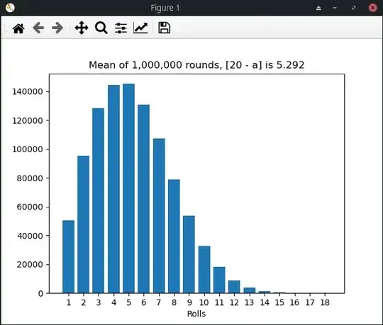

EDIT: Adding distribution, continuing from earlier python:
import matplotlib.pyplot as plt
import numpy as np
text = f"Mean of {rounds:,} rounds, [20 - a] is {mean(results):.3f}"
fig, ax = plt.subplots()
ax.set_xlabel('Rolls')
ax.set_title(text)
labels, counts = np.unique(results, return_counts=True)
ax.bar(labels, counts, align='center')  # bar > hist
plt.gca().set_xticks(labels)
plt.show()
Distribution Graph

    +1 but it would be nice if you could add a distribution. We know that chance for success at first roll is 1/20, but chance that sequence will end at second one, third and so on would be pretty cool, too. – Mołot Oct 13 '22 at 14:32
  • @Mołot I've added the code to create a plot, but I had trouble with uploading the image so I had to upload it manually to imgur and link it. – import random Oct 13 '22 at 15:07
  • @importrandom I am trying to upload an image and I am having troubles too: there are some server errors. – Eddymage Oct 13 '22 at 15:09
    @Eddymage I was able to embed the image by uploading to imgur, then using the link to the PNG ![title](https://i.imgur.com/7uzEok0.png). – import random Oct 13 '22 at 15:18

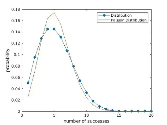

So you have to wait between 5 and 6 rolls before achieving a success: the computational answer by import random confirms this computation.
Below you can find the plot if the distribution, together with a comparison with respect to the Poisson distribution.
Plot of the distribution, comparison with Poisson distribution for reference.
As justforplaylists notes, the median is 5: it means that 50% of the time you expect a number of rolls less or equal than 5 for having a success, in the other 50% you have to wait from 6 to 19 rolls.

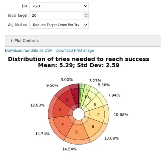

If I'm reading correctly, the fundamental prompt centers around the ability to (efficiently) iterate on variations of a game mechanic. Those more skilled than I am are better suited to derive a generalized formula mathematically, but I can at least provide some means for tinkering, in this case using dyce¹ for computation and anydyce² for rudimentary interaction.
You can try it out in your browser: Try dyce [source]
base screenshot
While admittedly a little clunky, the interface allows the user to select a die from the standard polygonal dice, define a target, and select an adjustment function from one of two predefined methods identified in the initial question. It also affords custom inputs for advanced users (more on this below).
Using dyce to Model the Mechanic
dyce uses discrete computation, meaning it achieves precision without randomized sampling. It doesn't do continuous distributions, but it will get you precise results, assuming it can adequately model the problem.

This gives us what we want:
>>> d20 = H(20)
>>> h = degrading_target_performant(d20, 20)
>>> print(h.format(scaled=True))
avg |    5.29
std |    2.59
var |    6.68
  1 |   5.00% |#################

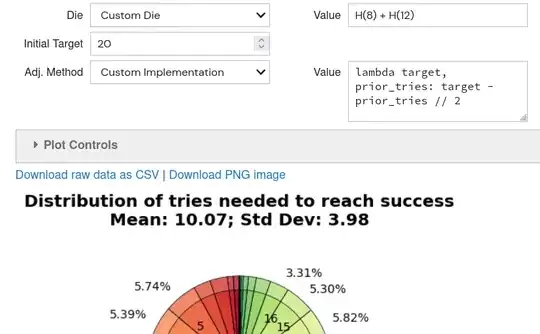

Now we can turn to enabling experimentation. We have already parameterized the die and target we're using. Astute coders will note that we can refactor the above to also parameterize the means by which we compute the adjusted target. The substantive source to our version can be found here.
Custom Inputs
For those familiar with Python and dyce, one can input one's own custom histogram for the die (e.g., 2 @ H(6) for 2d6) and one can even define one's own custom target adjustment function that takes two arguments (target and prior_tries) and returns the adjusted target. The custom function can either be defined as a lambda expression, or it can contain full-fledged Python code (so long as it defines or assigns a callable of the appropriate signature to the _ symbol).
For example, to see how the mechanic would work with a d8 plus a d12 and an adjustment function that reduces the target ever other try, one could use a custom die of H(8) + H(12) and a custom adjustment function of lambda target, prior_tries: target - prior_tries // 2, or, if one prefers, something like:
def my_adjustment_func(target: int, prior_tries: int) -> int:
  return target - prior_tries // 2
_ = my_adjustment_func # <-- "export" the function by assigning it to the _ variable
customization screenshot
One word of caution when experimenting with your own adjustment function: it must converge, meaning it must eventually result in a 100% chance of success (e.g., a target of the minimum value of the die range), or the computation will never finish. I'll leave it as an exercise to the reader to think about how one might go about introducing a safeguard.
