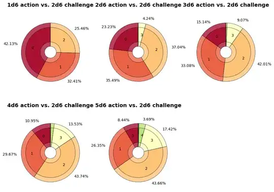

My AnyDice Fu is lacking, so this is a dyce¹-based solution, but I believe is otherwise directly responsive and captures my understanding of the mechanic, although I'm not sure I've understood everything completely.
from dyce import P
from dyce.p import RollT
def ironsworn_bitd(action_roll: RollT, challenge_roll: RollT) -> int: max_action = max(action.roll, default=0) max_challenge = max(challenge.roll, default=0) if max_action == 0 and max_challenge == 0: return 0 basic_successes = sum(1 for c in challenge_roll if c < max_action) num_action_matches = sum(1 for a in action_roll if a == max_action) - 1 if max_action < max_challenge: match_successes = 0 elif max_action > max_challenge: match_successes = num_action_matches else: # max_challenge == max_action: num_challenge_matches = sum(1 for c in challenge_roll if c == max_action) - 1 # Offset the number of action matches by the number of challenge matches up to # the number of action matches match_successes = max(0, num_action_matches - num_challenge_matches) return basic_successes + match_successes
h = P.foreach(ironsworn_bitd, action_roll=4@P(6), challenge_roll=2@P(6)) print(h.format(scaled=True))
Output:
avg |    1.66
std |    0.92
var |    0.85
  0 |  10.95% |############
  1 |  29.67% |#################################
  2 |  43.74% |##################################################
  3 |  13.53% |###############
  4 |   1.99% |##
  5 |   0.12% |
You can play around with a more generalized version in your browser: Try dyce [source]
The above favors readability and consistency with the original sentiment. It can certainly be simplified. To limit the successes to 3, change the statement return basic_successes + match_successes to return min(3, basic_successes + match_successes) and re-run it.
While a matter of taste, I find anydyce's² "burst" graphs are well-suited to visualizing distributions.
anydyce burst graphs
¹ dyce is my Python dice probability library.
² anydyce is my visualization layer for dyce meant as a rough stand-in for AnyDice.

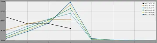

function: roll ROLL:s vs CHALLENGE:s {
  M: 1@ROLL
  N: M = ROLL
  H: 1@CHALLENGE
  L: 2@CHALLENGE
S: (M > L) + (M > H) if M = H & H = L & N > 2 { S: S + N - 2 } if M = H & H > L & N > 1 { S: S + N - 1 } result: S }
loop X over {1..6} { output [roll Xd6 vs 2d6] named "[X]d6" }
The output of this program looks like this (in graph mode):
AnyDice graph screenshot

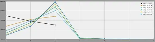

For example, here's what the output looks like with three challenge dice instead of two:
AnyDice graph screenshot with three challenge dice
