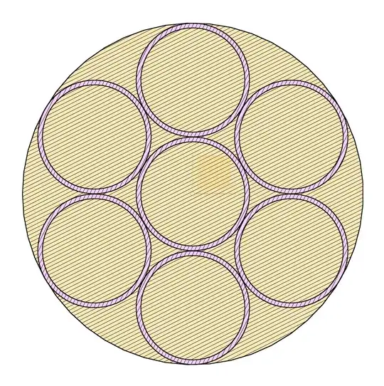

To calculate the maximum amount of barrels that would fit in each layer we need to basically solve the problem of smaller circles inside a larger circle, I have used this caclulator here for that: Smaller Circles within a Larger Circle - Calculator. Putting in a portable hole’s diameter as the large circle and a barrel’s as the small one, the result it produces is 7. It would look like this viewed from the top: big circle with a ring of 6 smaller circles inside, and one more smaller circle inside
So to put this together, 7 barrels in layer × 3 layers gives us 21 barrels that would fit into a portable hole.

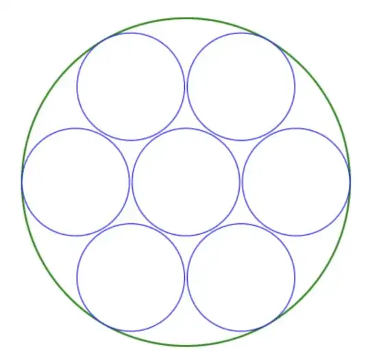

densest packing of 7 barrels in a layer
Assuming that the barrels are perfectly cylindrical, each barrel would need to be 1 foot 3 inches tall to fit the 4 cubic feet volume (\$\frac V \pi=h\$). Let's round that to 1.5 feet to account for at least some shell that holds these contents.
That means we could have 6 complete layers of 7 barrels or 42 barrels. Or rather, Jerry-cans, as we only accounted for a rather small shell here.

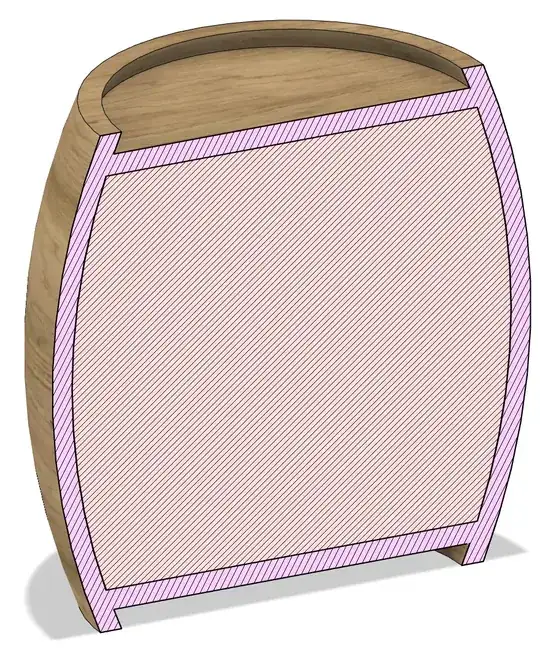

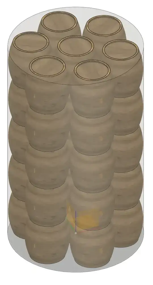

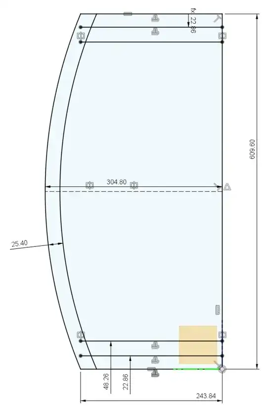

35 classic barrel shaped barrels of 4 cubic feet volume
Now, let's assume the barrels have a 1-inch wood frame, and a 1 inch wood lid. That lid should be at least half an inch inch indented from the top and bottom of the barrel jacket's end. It needs to contain 4 cubic feet of volume or 113.27 liters. Since water has a density of pretty much 1, that's 113.27 kilos of water in that barrel. This happens pretty perfectly with the lid being between 0.9 and 1.9 inches from the top edge, when the barrel is 0.8 feet radius at top and bottom of the jacket. And we demand a round number of feet for the height, so math gets easier. After some experimentation, the measurements in millimeters read like this (sorry, my CAD only outputs mm, it allows me to put in variables in inch though):
rotational body of the barrel
This results in 2-feet tall barrels of 2 feet maximum outer diameter while the top and bottom of the barrel curve in to have a 1.6 feet diameter at the ends. Perfect!
The barrel in question
Stacked as before, we get a perfect fit of 5 layers of 7 barrels each, for exactly 35 barrels in total.
35 barrels stacked in the portable hole

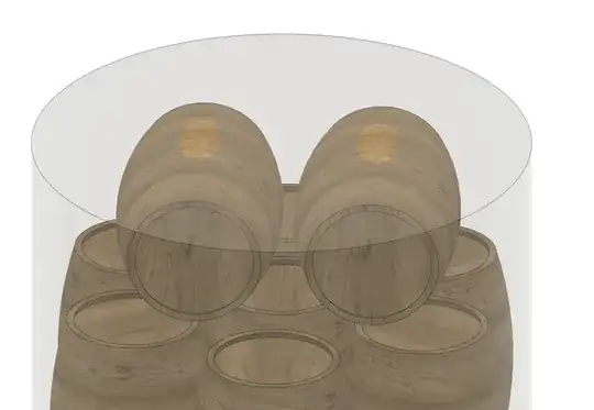

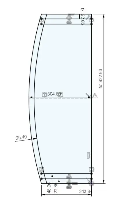

21 barrels of 40 gallon (+2 malformed ones)
40 gallons are 151.42 liters of water. Using the same basic barrel geometry as before, our 4 gallon barrels need to be 2.7 feet tall to get that (and a tiny bit) of volume.
We can still store 7 per layer, but we only manage to stack \$\frac {10}{2.7}=3,7\$ into the hole, so 3 complete layers for \$3*7=21\$ barrels
If you have two slightly ovaloid barrels or a pair of longer but slimmer barrels, you might manage to get those in as extra: on their flat side on top of the stack. enter image description here

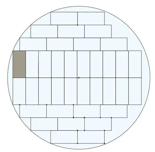

Bonus: 180 x 20 liter Wehrmachts-Einheitskanister - original "Jerry Can"
A proper Jerrycan is of the following dimensions: 165x345x470 mm. Stacking those in a portable hole gives this pattern of 38 cans per layer:
6 complete Layers fit into the hole, so 6*28=168 canisters filled with 3360 liters of water or fuel. Or 887,6181 gallons for the imperial types - the equivalent of a little over 22 barrels of 40 gallons. But the standing Jerry cans still leave just enough space above for a top layer of 10 extra cans laying on the side:
That's 200 more liters, for a total of 3560 liters or 940.4525 gallons. The equivalent of 23.5 barrels.
Wait, there's even a better stacking with 12 extra lying cans, for 40 more liters, so a total of 180 times the 20-liter canister. 3600 liters stacked in German engineering!

The barrels will not fill that space fully, as they are more or less cylindric in form. If they were ideal cylinders, you could apply circle packing in a circle as long as the height of the barrels fits in. We'll start from there.
The portable hole creates a cylindric space 10 feet deep and 6 across:
It unfolds into a circular sheet 6 feet in diameter. (…) the portable hole creates an extradimensional hole 10 feet deep.
The description of barrel in the rules says:
A barrel can hold 40 gallons of liquid, or 4 cubic feet of solid material.
4 cubic feet would only be about 30 gallons. I think for this exercise we need to use the liquid volume, which will more closely reflect the full space used. The 4 cubic feet for solids must assume there is a lot of empty space wasted within the barrel if you pack in solids, not that the dimensions would be smaller.
The dimensions of the barrel are also not exactly defined, but barrels are taller than they are wide. Today, a typical 40 gallon wood barrel is about 2.9 feet high, and would have a diameter of a bit more than 1.5 feet, if perfectly cylindrical. However, the belly diameter of such a barrel would be more like 2 feet, as other than modern metal barrels, wooden barrels are not really cylindrical, they are thicker around the middle. The rounded side profile of the barrel will lose you some additional space, as will the thickness of the wood. In medieval times things were not as standardized, but we'll use these dimensions as placeholders.
At these dimensions, you could pack in only three layers of barrels, and at a ratio of 3 to 1 for the thickest point of diameter, you could pack 7 barrels per layer.
7 Barrel packing
This will result in a total of 21 barrels. All assuming that there is no other way to pack them denser by tumbling them in and treating them more like spheres in a cylinder.

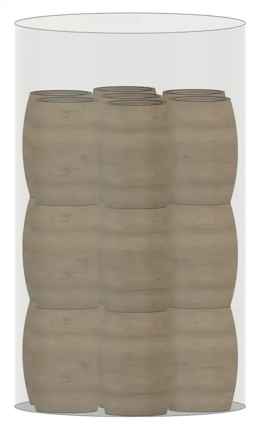

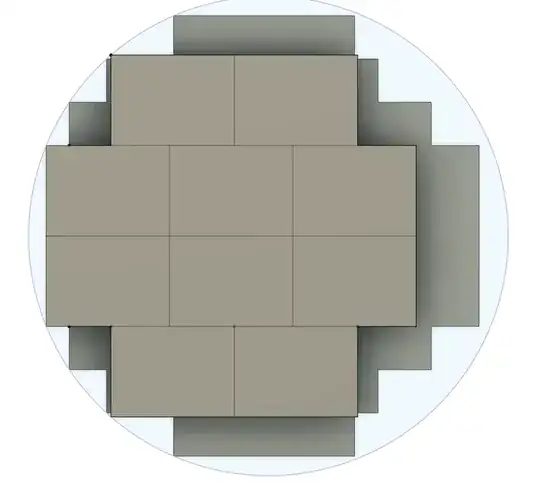

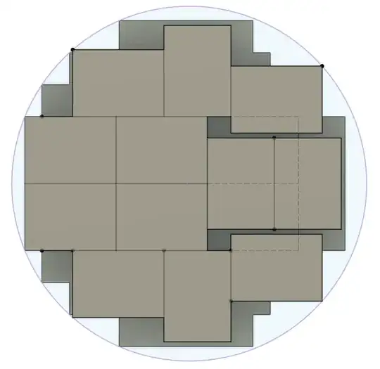

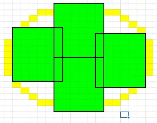

Building on AnnaAG's answer of 21 40 gallon barrels.
I think you can get 22 barrels in.
I'm making the case that you could get 4 barrels in 1 layer on their side. 4 sideways barrels in a cylinder
There is some overlap in the image but I think that can be ignored because of
  • the curvature of the barrels
  • the barrels actually being 8.8 squares high not 9 like in the image
If you allow that then you can stack the barrels in the following way:
  • 2 layers of 7 upright barrels which is 176 cm
  • you would then have 128 cm left at the top which is enough for 2 sideways barrels on top of each other (120 cm)
  • which means you can have 2 layers of 4 sideways barrels
  • for a grand total of 2*7+2*4=22 barrels, an increase of 1 barrel!

    Nice answer, +1, I considered putting the barrels sideways but didn’t think you could fit in more – AnnaAG Jul 18 '22 at 16:50
