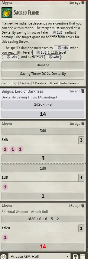

So a brief sanity check we can perform on these odds, before we go further, is to note that none of these outcomes are terribly unlikely. The second condition happens more frequently than the odds of someone happening to roll a natural 20 on a d20 on any given roll, and we don't generally assume that any person who happens to roll a natural 20 is cheating based on that one roll. And there are a lot of improbable events that happen all the time that we generally would not think of as being evidence of cheating despite their absurdly low probability. As an example, I'll submit this combat log from a session my group had about a month ago, where on a 4d8 roll, our cleric rolled four ones, and then promptly rolled a natural 1 on her subsequent attack roll:
And, just so it doesn't go unstated: I can personally verify, as the DM and maintainer of the VTT these results were obtained upon, that these were fair results, despite the fact that the odds of this happening were about 0.00122% (or, 1 in 81,920).
But, I should also not leave unstated: that was a cherrypicked result from a long series of rolls over the course of a campaign that has run almost every week over two years. You could dig into any campaign and find individual runs that were at least as unlikely, perhaps even moreso.
