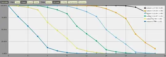

If you believe that for a given character the six scores are each worth a constant amount per point, then the optimal strategy is to allocate your top three dice to the most important score, the next three highest to the second-most important, and so forth.
Here's what happens if you do this:
At Least graph.
AnyDice.
The six curves represent the chance of rolling at least X on your highest score, second highest score, etc. Note that the joint distribution of the six scores is not independent.
The "median" array is 18, 15, 12, 10, 7, 5. In particular, you have about a 2/3 chance of getting at least one 18. Compared to standard array or 4d6-drop-lowest, the ability to allocate higher primary scores comes at the cost of a lower mean score.

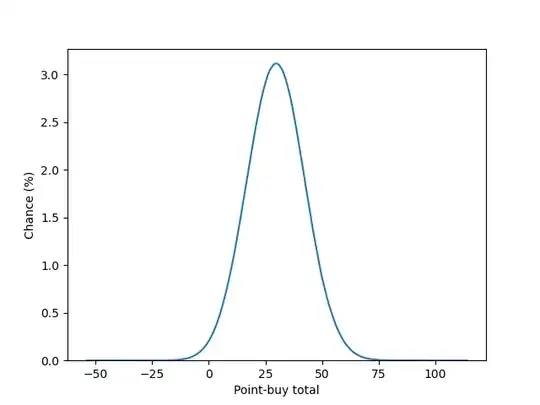

Distribution of point-buy costs
It's possible to compute the exact probability distribution of the total point-buy cost of this strategy in polynomial time. The key elements are:
  • Iterating through faces rather than through dice.
  • Using binomial coefficients to quickly go through the possibilities of how many dice rolled each face, rather than which dice rolled each face---the former is polynomial, while the latter is exponential.
  • Dynamic programming/memoization to cut out redundant intermediate calculations: there are only a polynomial number of possible running totals and remaining dice.
Here's a Starboard notebook that computes the exact distribution for this strategy. You can compare this to my calculator for a variety of other ability score generation methods.

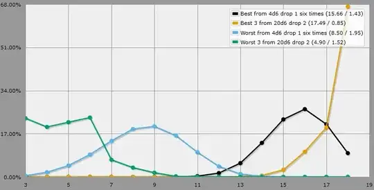

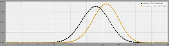

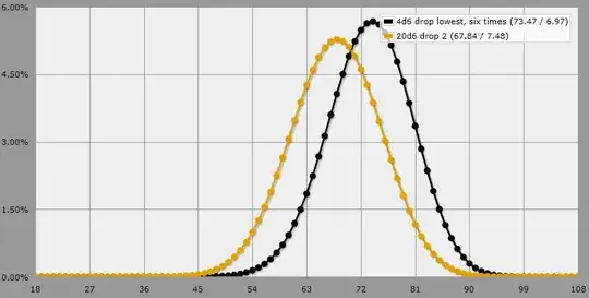

It is fairly hard to statistically analyze your system because there's a lot of human decision making involved. Depending on how your players choose to assign the 18 dice they have for their stats, you may find you have different balance issues. But there are a few things that are clear:
First, a characters' total stats will be a bit worse on average. As this AnyDice program shows, the total of all the character's attribute scores will average about 6 points less than with the standard rolling method. That's not huge, but it's not trivial either.
graph of total stat values

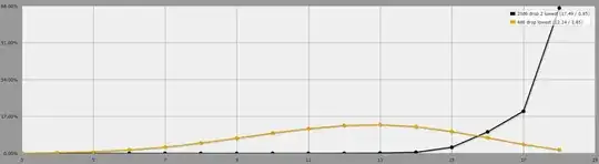

The other significant difference is how easy your system will make it for the player to get exceptionally high or low scores for certain attributes. It is very rare for a PC to start with an 18 or a 3 in a stat, but in your system is will be very easy for a player to choose a combination of dice that give them stats like that. Almost every roll will give at least 3 sixes for the player to use for their best stat, if they want to. And while ones are a bit rarer (since the lowest two dice are dropped), there are still going to be a lot of low dice that will often go into "dump" stats that the player hopes never to roll.
Here's another graph showing the highest and lowest possible rolls from each system (generated by this AnyDice program).
graph of highest and lowest possible stat values

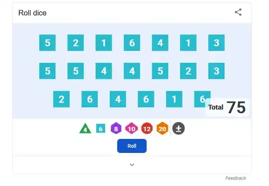

Okay, so as one of your players i've just rolled my stat generation dice.
I'm going to play a Fighter. I've selected my race as Half-Orc. I place 3 6's into Str, giving me 20 Str (18 + 2 racial). I place 6 5 5 into Con, giving me 17 Con (16 + 1 racial). I take 5 5 4 into Dexterity, giving me 14 Dex. I decide I want a good Wisdom, for Perception checks and saving throws. So I put 3 4's into Wis, giving me 12 Wis. That leaves me with 2 3 3 to put into Charisma, giving me 8 Cha, and 2 2 1 to put into Int, giving me 5 Int.
20 Str 17 Con 14 Dex 5 Int 12 Wis 8 Cha
This method allows me to minmax whichever scores I desire most above others, resulting in very focused characters with lower-than-usual 'dump' scores. If you like 3 cha fighters and 5 str wizards, this may be ideal for you.
Overall I would rate it lower than most other methods, including the simpler 'roll 4d6 drop 1'.

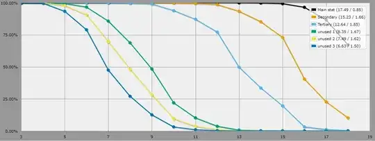

It is rather tough to directly compare your method with "4d6 drop lowest". Looking at the total score it might look like your method is overall weaker with an average of ~67 compared to ~73 for "4d6 drop lowest". Total score comparison
However, you allow the 18 remaining dice to be grouped however the player wants which can be rather powerful. This is hard to visualize in a single graph so to illustrate let's look at the probabilities when grouping the highest 3 dice together, which will be the highest one of the player's stats can be and in practice what most players will likely do for their class' primary stat.
Primary stat probability
There is a ~67% chance a player will have the option to have a score of 18 in their primary stat (before class bonuses), compared to the mere ~2% when using "4d6 drop lowest".

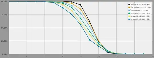

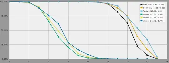

You do not give any ways that you think your players will use your method, so I'll use the way I would do it.
First I try to get my 3 main stats as high as I can. On most characters, this would be my attack stat, then Dex or Con depending on what kind of character I'm playing. Then the rest is divided as evenly to get as few glaring weakness since I do not expect to actually use those stats, I just don't want a glaring -3 on a skill or a save if I can avoid it. Lastly, my race will probably give me a bonus to my first and either my second or third highest stats.
The 20d6 method
Here is what I get with this strategy Anydice. The lines are the chances of getting at least X.
Notice how the two main stats are very likely to be at least 17 and 15 before taking into account races. With the third stat around 12-13.
Also notice how the last three stats tend to be close to one another. Similar to the standard array and 4d6 methods.
On a personnal note, I would never take an ASI over a feat with those numbers.

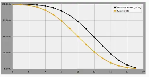

Comparison with 4d6
For reference, here is the probability curve for 4d6-drop-lowest and 3d6 (Taken from an article on Anydice). I will be basing the following on this curves as well as my personal experience with rolling a complete array with 4d6.
The main stat can be safely expected to be a 15-16 (+3 or better with races). With the bulk of the stats falling between 12 and 14 (+2 for important stats, +1 for most of them). And the lowest being -1 or +0.
Compared to this, your method gives:
  • a guaranteed +1 or +2 for the main stat when compared with 4d6;
  • a guaranteed +1 for the two secondary stats
  • the lowest stats are -2 compared with expected results form 4d6.
