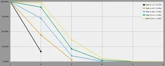

Ps. If you want, it's also quite easy to tweak the program to calculate these probabilities for several different dice pool sizes and to graph the results:
AnyDice screenshot

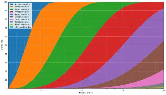

Stacked area plot up to 20 dice
Stacked area plot of matching set size.
This was generated using the algorithm from my CthulhuTech answer. Though for this specific problem Dale M's balls-into-bins formulation is probably easier to understand.
