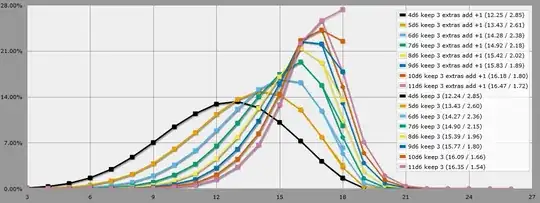

The output is somewhat underwhelming, since your bonus points for having lots of extra maximum values on your dice rarely happens. You need very large die pools relative to the number of dice you're keeping for the rule to have any noticeable effect. Here's some code that computes the distributions for keeping three dice from varying pools of d6s. The effect of the special rule only really matters for pools that are many times larger than the number of dice you're keeping.
D: 6
K: 3
loop N over {K+1..K+8} { output [N of D keep K extras add] named "[N]d[D] keep [K] extras add +1" } loop N over {K+1..K+8} { output {1..K}@NdD named "[N]d[D] keep [K]" }
graphs of statistical distributions
Your special rule only effects the small part of the graph over on the right, where the circle-marked lines diverge from the square marked lines out beyond 18 (the normal maximum for 3d6). For values less than 18 (which is 95% or more of the distribution for most of the pool sizes), the two kinds of lines are exactly coincident.
