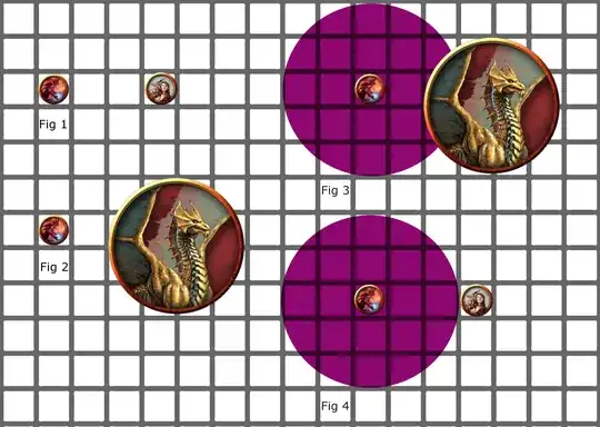

A level 20 wizard and a level 20 druid stand with 10 feet of space between them (figure 1).
To begin their battle, the druid casts shapechange, transforming into an ancient brass dragon, a Gargantuan creature (figure 2).
To counteract this, the wizard casts antimagic field (Player's Handbook, page 213) which creates a field of anti-magic in a 10-foot radius sphere around the wizard within
"Spells and other magical effects, except those created by an artifact or a deity, are suppressed in the sphere and can't protrude into it."
It seems clear-cut that shapechange is suppressed until the druid exits the antimagic field, and so reverts to its normal, medium form (figure 4).
Now the druid's smaller, Medium form, is no longer within the antimagic sphere. So it should regain the effects of shapechange, transforming back into an ancient brass dragon—which immediately puts its form back into the antimagic field, repeating the process. If it were another buff spell, such as fire shield (Player's Handbook, page 242), that doesn't affect the target's size, this would be a nonissue. But shapechange, along with enlarge/reduce (Player's Handbook, page 237), polymorph (Player's Handbook, page 266), and any other spell that might increase the target's size run into this issue. enter image description here

If you maintain creature positions, the effect is simply suppressed and the druid remains in its typical form
The druid can't take the Brass Dragon form when some portion of that form would intersect the region affected by the anti-magic field. The order of events, as described in the question, is as follows:
  1. The druid changes into the dragon
  2. The druid-as-dragon moves such that part of its body enters the anti-magic area (or is already in an area which causes part of its body to be in the anti-magic field's area of effect when it is created)
  3. The anti-magic effect immediately ends the transformation, reverting the druid to its normal form
  4. The druid, as a medium-sized creature, is no longer in the zone affected by the magic suppression, and so the suppressed effect stops being suppressed and the druid resumes dragon form
  5. As no movement has occurred, the dragon's form once again intersects the anti-magic field, and the effect is suppressed again
  6. Repeat ad infinitum

Space permitting, the druid decides
It is essential to understand that just because an ancient brass dragon is Gargantuan, does not mean that it occupies the entirety of a 20' x 20' square. Rather, DMG Chapter 12 (Monsters) says:
Size. The Size Categories table shows how much space a creature of a particular size controls in combat...
and PHB Chapter 9 (Combat) says
Creature Size. Each creature takes up a different amount of space. The Size Categories table shows how much space a creature of a particular size controls in combat...
Space. A creature's space is the area in feet that it effectively controls in combat, not an expression of its physical dimensions. A typical Medium creature isn't 5 feet wide, for example, but it does control a space that wide...A creature's space also reflects the area it needs to fight effectively...
Squeezing into a smaller space. A creature can squeeze through a space that is large enough for a creature one size smaller than it...While squeezing through a space, a creature must spend 1 extra foot for every foot it moves there, and it has disadvantage on attack rolls and Dexterity saving throws. Attack rolls against the creature have advantage while it's in the smaller space.
Thus, one simple resolution is to reposition the body of the dragon such that the entirety of its physical form is outside of the antimagic field (without actually moving it - this is an absolute reduction in squares occupied, not a shift in squares). The druid would be permitted to retain the form of a dragon, but would not be permitted to control any space in which the field covered more than half the square. At the discretion of the DM, if this sufficiently restricted the area available to the dragon, it would also be subject to the squeezing condition.
The DM could rule that this simply happens per force to the positioning of the dragon, similar to other shape change effects that automatically take account of environmental circumstances. Or, the DM could allow the player of the druid to decide, and give them the choice: "In response to the antimagic field, you can adjust your positioning to retain your shape as a dragon. If you choose not to, you will resume your shape as a druid until such time as you can move further away from the field." I would suggest the latter, since as a DM I try to give players more choices and more autonomy.
Some might object that the druid could not adjust their position when it is not their turn. I consider this analogous to the standard condition of changes of facing being free even when it is not one's turn, being able to use a shield to defend against attacks from any direction, etc. (basically everything that is allowed when one is not using the optional facing rules from DMG 252)
To sum up, when the dragon is affected by the antimagic, we can assume that the dragon form is maintained, but in a smaller number of spaces. Only when the dragon itself no longer fits in the spaces available is it forced to revert to the druid.
