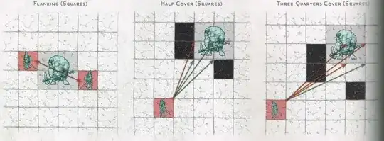

You see some thing similar for the section deterring cover on a grid, line of sight and cover revolve around the entire space occupied by the creature not just the creature itself.
