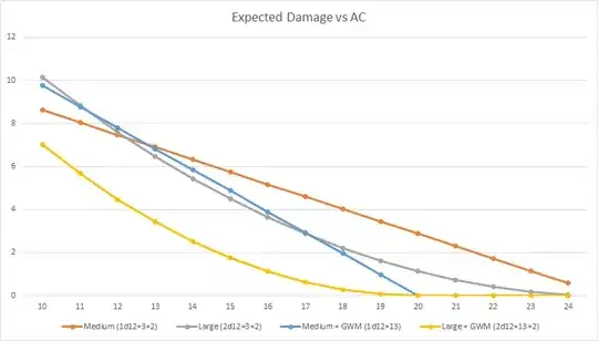

Taking a level 1 barbarian with a strength of 16 wielding a medium or large great axe I created the chart below. (Charts ignores critical hits)
Expected Damage vs AC

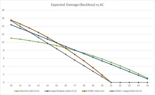

As you can see from the chart, against most reasonable ACs (13+) you are better off using a medium weapon. At level two you gain Reckless Attack, assuming you use it all the time the chart changes to the one below:
Reckless Attack vs AC
Once you have Reckless Attack some of the downsides of the medium weapon as removed. However against low ACs when the large weapon has an advantage against a medium one, you are better using Great Weapon Master and the medium weapon.
In summary, you are better off sticking with a medium greataxe and using Great Weapon Master in situations where the large weapon would benefit you.

    Great charts, but ignoring crits seems like a bit of an oversight; since damage dice are doubled on a critical hit, that could be one of the most important advantages of the using a larger weapon (more relevant with the Reckless Attack chart than the first one, since crit on disadvantage is only 1/400 times). – ESCE Apr 14 '21 at 17:46
  • @ESCE You are correct, but it made the math a lot harder to do. If I have time I'll revisit it to look at crit damage. – linksassin Apr 14 '21 at 23:50
