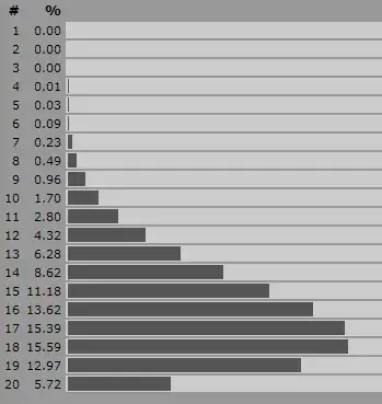

With one source of disadvantage, it takes 6 sources of advantage to have the same chance at a natural 20 as a straight roll.
Using this short anydice program:
ADV: 0
DIS: 0
output {1+DIS}@(1+ADV+DIS)d20
If we set advantage to 6 sources, and disadvantage to 1 source, our probaiblity of rolling a natural 20 is 5.72%:
I can't really say if this phenomenon is "broken", I guess that is up to you to decide, but the important observation for you to consider is that a single source of disadvantage severely neutralizes the effect that multiple sources of advantage has on getting a natural 20. 2 adv/1 dis gives only a 1.4% chance at a natural 20.
