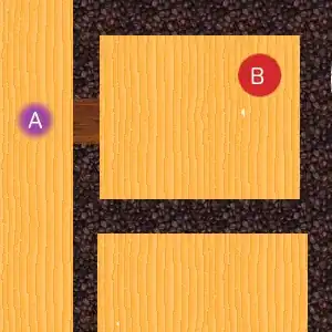

Consider the following situation (see figure below): creature A (on the Ethereal plane) is spying on creature B, which is inside a locked room with thick walls on the Material Plane. A spies B from outside the room, seeing through the Ethereal Plane. B decides to cast True Seeing because it suspects that there are hidden traps in the room. A becomes potentially visible to B as if they were on the same plane, but since it is outside the room (i.e. it has full cover due to the walls) B can not see it, since Truesight does not allow B to see through the walls on the Material Plane. Once A enters the room in the Ethereal Plane, however, B can clearly see it (if True Seeing is still active).
B is in the Ethereal Plane and it is spying A, which is inside the room with thick walls.
