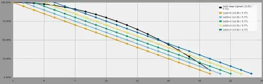

I'm trying to determine the probability of every modifier to a 1D20:
1D20 +1
1D20 +2
1D20 +3
1D20 +4
1D20 +5
vs flat 2D20s with advantage
2D20 (Keep highest)
3D20 (Keep highest)
4D20 (Keep highest)
Any help would be highly appreciated
You can use anydice to calculate and visualise the results from any die roll combinations you can think of.
This program will output a results for 2d20, alongside all of the results for 1d20 plus modifiers from 0 - 9. As this is rpg stack exchange, I assume you are probably interested in the probability of rolling at least a certain value. Outside of this range of modifiers, none of the multiple d20 curves intersect with those of the single d20, so the there is a clear "better" option.
loop N over {2..4}{
  output [highest 1 of Nd20] named "[N]d20 keep highest"
loop M over {0..9}{
  output (1d20+M) named "1d20+[M]"
All of those combinations make for quite a cluttered graph, but we can see what's going on in this version with just 1 vs 2 d20s:
Anydice graph
The black line shows 2d20 keep highest, and you can see that it is always better than 1d20+0. However, vs the green line which shows 1d20+3, the single d20 is better if you need to roll anything 3 or under, and again if you need 19 or higher.
Anydice will also give you the numerical probabilities for each roll.

    You can find how far off the results are with this sort of anydice function: https://anydice.com/program/1cddd intuitively the less area under the curve the better, which looks like +4 or +5 – AncientSwordRage Jul 25 '20 at 00:14
  • Note that this (both the answer and the linked anydice program in the comments) are concerned only with the average roll. This answer would be improved by addressing why that's the best metric. – Please stop being evil Jul 25 '20 at 16:46
