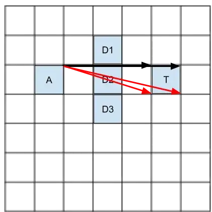

The only case I can think where these might collide is something like the following:
multiple character cover
Individually T would not get cover from D1 or D3 and only get half cover from D2. The DMG seems to indicate T might get full cover since all 4 lines would be blocked. However if you use the guidance from the PHB (as shown above) T would only have half cover.
Seems to me it's just a judgement call which interpretation is correct. Anyone know of any rules that clarify this other than a judgement call?
EDIT: assume D1, D2, and D3 are separate obstacles or monsters.

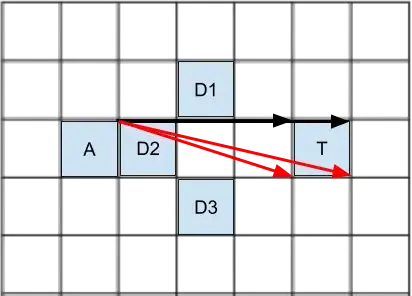

Maybe this makes it more clear:
separate defenders
