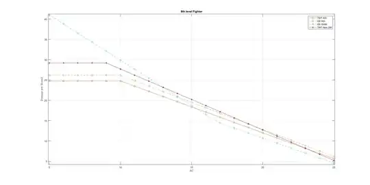

At 6th level, it starts getting interesting as we get +ASI in our primary attribute and that is used in each of our attacks. However, GS + GWM still outdamages this feat for low ACS (AC <= 13), GS + ASI outdamages for high ACs (AC >= 19), and the feat is the best option for mid-range ACs (13 <= AC <= 19). Note that this still comes at the cost of being vulnerable to enemy attacks with advantage. An example figure for better visualization.
At 8th level, we get a +5 modifier in our main attribute and the feat starts to shine. It can only be outdamaged by GS + GWM for low ACs (<= 11), and shines for anything higher than that.
As we get higher proficiency bonuses and GWM starts to hit more often at higher ACs, GWM comes back against enemies up to 14 AC, however, the new feat still shines against high ACs - which are arguably more common at higher levels.
