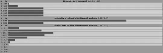

PS. I couldn't resist the temptation to verify this calculation using AnyDice. To model the reroll mechanic, I used a generic helper function from this answer:
function: ROLL:n reroll BAD:s as REROLL:d {
if ROLL = BAD { result: REROLL }
result: ROLL
Using the function, we can easily obtain the distribution of results for one rerolled die:
DIE: [d6 reroll {1,2} as [d6 reroll 1 as d6]]
output DIE named "d6, reroll 1 or 2, then reroll 1"
I assigned this distribution to a custom die (imaginatively named DIE) so I could use it to calculate the success / failure distribution for a single trial (i.e. the probability of rolling a 6 on a single rerolled d6):
TRIAL: DIE = 6
output TRIAL named "probability of rolling 6 with this reroll mechanic"
Here, TRIAL is a biased two-sided die (or coin) that rolls 1 if the Bernoulli trial is a success and 0 if it's not. Using this biased die, we can get the distribution of successes over 10 trials simply by rolling it 10 times:
output 10dTRIAL named "number of 6s for 10d6 with this reroll mechanic"
The results, plotted as bar charts, look like this:
