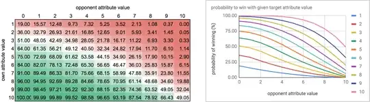

Ps. I used the Python script from this answer and Google Sheets to draw a heat map and a line chart showing the probability of a player with attribute A winning against an opponent with attribute B:
Heat map and line chart
One notable observation evident from these charts is that players with low to moderate attribute values have a non-negligible chance of tying even against an opponent with attribute 0, since a mutual double failure is always a tie.
In general, if both players have lowish attributes, your mechanic tends to produce a lot of ties, which could make the players feel like they're both ineffectually flailing at each other without actually accomplishing anything. Of course, this might or might not be a problem, depending on what kind of a feel you want low-level combat to have in your system.
