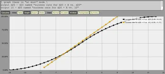

Let's first simplify the problem by setting X = AB. It should be clear that the success rate of d20 + X vs. a plain d20 is the same as for d20 + A vs. d20 + B. Similarly, the success rate of d20 + X vs. 10 is the same as for d20 + A vs. 10 + B.
It turns out that, for X close to 0, both of these methods give similar odds, with the roll vs. 10 being slightly more likely to succeed due to the fact that, as you note, the average of d20 is 10.5 rather than 10.
However, for sufficiently large X, rolling against 10 is a lot more likely to succeed. In particular, X ≥ 9 or higher obviously always succeeds against 10, but the success rate of d20 + 9 vs. d20 is only 86.25%.
Conversely, for sufficiently negative values of X it's better to roll against a d20 rather than against 10. In particular, X ≤ −11 always fails against 10, but d20 − 11 vs. d20 still has an 11.25% chance of success.
Looking at the output of this AnyDice program, the break-even point turns out to be at X = −5, where both methods give a success rate of exactly 30%:
Screenshot
So, in conclusion, rolling d10 + A vs. d20 + B and rolling it vs. 10 + B are approximately equivalent as long as the difference between the bonuses A and B isn't too large. But if the difference gets close to ±10 or more the two methods start to give significantly different success rates.
