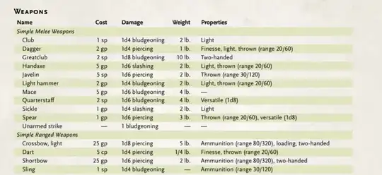

1 In the original printing of the basic rules and the PHB, unarmed strikes were listed as melee weapons and included on the table of weapons (right below Spear):
In the first PHB errata in 2015, the designers removed "unarmed strike" from the weapon table and added the current text on unarmed strikes on page 195 quoted above - that text (redundantly) bakes the general rule for adding modifiers to weapon attacks into the rule for unarmed strikes. (Some attacks require weapons, - paladins' Divine Smites - and the devs apparently used this errata to prevent hand inflicted Divine Smites, among other things. Thus the SA comment about "special kind of weapon attack")

    One thing I wonder: unarmed strikes, in the original printing, did appear on the weapons table but were removed in an errata. Did the writers perhaps neglect to update the wording on how unarmed strike damage is calculated in conjunction with this change? – Rykara Nov 05 '19 at 19:44
  • @Rykara: I believe that the new definition of the unarmed strike's damage as 1 + Str mod was the writers' attempt to keep the same total damage by hardcoding in the ability modifier. – jwodder Nov 05 '19 at 19:48
