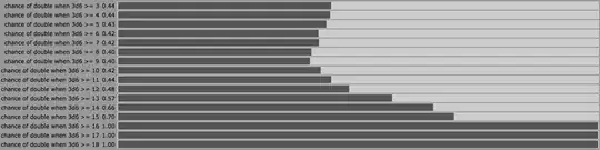

  2. When an attack does succeed, it triggers pretty often. Ignoring the success requirement, the probability of rolling a double (or a triple) on 3d6 is exactly 4 / 9 ≈ 44.4%. The success requirement changes this a bit, since the probability of a double varies depending on the total sum rolled (in particular, it's 100% for rolls less than 6 = 1 + 2 + 3 or greater than 15 = 4 + 5 + 6), but it never goes below 40%:
    Bar chart of the probability of rolling a double on 3d6 when the sum is over a given target

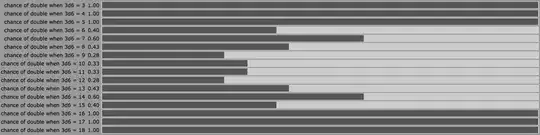

  3. Except for the success requirement, it's not strongly correlated with the sum of the roll. In fact, the AGE mechanic is symmetric in the sense that the probability of getting a double on a roll of 3 + X is exactly the same as on a roll of 18 − X:
    Bar chart of the probability of rolling a double on 3d6 when the sum is exactly equal to a given target
