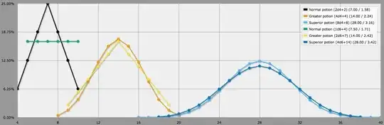

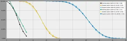

Let's not overcomplicate it: a simple Nd6 + X formula will work just fine.
Specifically, the effects of Greater (4d4 + 4) and Superior (8d4 + 8) healing potions are quite closely replicated by rolling 2d6 + 7 and 4d6 + 14 respectively. These formulas yield exactly the same average number of hit points healed as the originals (14 for Greater and 28 for Superior potions), and the shapes of the distributions are quite close.
For normal healing potions, naïvely applying the same conversion formula would require us to roll 1d6 + 3.5. Rounding this up to 1d6 + 4 makes these modified potions slightly better (by 0.5 hit points, on average) than the originals, which your players probably won't mind. It also somewhat compensates for the extra "swinginess" (i.e. higher variance) of rolling a single d6 vs. rolling 2d4.
Here's a graph from an AnyDice script demonstrating these distributions:
Graph of D&D 5e healing potion formulas and alternatives using six-sided dice
In particular, rounding the healing amount for the standard potion upwards ensures that the modified potion always have the same or higher chance of healing at least N points as the original, for any N, which is probably desirable. The following graph, plotted from the same script as above, shows the cumulative probabilities of healing at least N points using all these formulas:
Cumulative graph of D&D 5e healing potion formulas and alternatives using six-sided dice
BTW, for Supreme healing potions, 5d6 + 28 will give a rather good approximation of the standard 10d4 + 20 formula. As with the standard potion, the average amount healed per potion will be half a hit point higher than with the original formula (45.5 points vs. 45 points), but at these levels that's not really noticeable. The AnyDice script linked above also includes these formulas, but they're commented out by default.
Just for completeness, here are all the original and d6-based formulas in a convenient table:
$$\begin{array}{l|rrrr|rrrr} & \text{Original} &&&& \text{d6-based} \\ \hline \text{Potion type} & \text{HP gained} & \text{Min} & \text{Avg} & \text{Max} & \text{HP gained} & \text{Min} & \text{Avg} & \text{Max} \\ \hline \text{Normal} & 2{\rm d}4+2 & 4 & 7 & 10 & 1{\rm d}6+4 & 5 & 7.5 & 10 \\ \hline \text{Greater} & 4{\rm d}4+4 & 8 & 14 & 20 & 2{\rm d}6+7 & 9 & 14 & 19 \\ \hline \text{Superior} & 8{\rm d}4+8 & 16 & 28 & 40 & 4{\rm d}6+14 & 18 & 28 & 38 \\ \hline \text{Supreme} & 10{\rm d}4+20 & 30 & 45 & 60 & 5{\rm d}6+28 & 33 & 45.5 & 58 \\ \hline \end{array}$$
A nice thing about this method, in my opinion, is that it should work really well with your test tube based physrep idea. All you need to do is put the appropriate number of six-sided dice (1, 2, 4 or 5) in each tube, and add a sticker with the fixed number of points to add (+4, +7, +14 or +28). No fancy math or rerolls or relabeling dice required. Simple!
(Alternatively, if you'd prefer your Greater and Superior healing potions to retain the property of being exactly twice and four times as good as a normal potion, you could adjust the fixed parts of their d6-based formulas up to +8 and +16 respectively. The Supreme potion doesn't follow this pattern even with the original formulas, but adjusting its additive constant up to something like a nice round +30 would probably be reasonable if you choose this approach.)

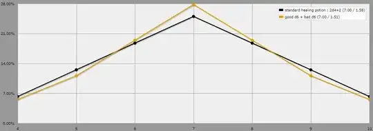

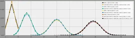

15
With a healthy mix of good and bad dice.
Potions use d4 in pairs. A single d6 can be altered to allow only 4 different outcomes: the downside is that it becomes unfair. You can compensate this by creating another d6, with its own 4 different outcomes, so that it generates fair results when rolled with the other one.
Different dice colors will help you:
  • Use white or green for "good dice".
  • Use black or red for "bad dice".
Using standard dice: just flip them!
Good dice can't roll bad numbers. Flip them whenever you roll 1 or 2 : result becomes 6 or 5. The dice's distribution becomes {6,5,3,4,5,6}.
Bad dice can't roll good numbers. Flip them whenever you roll 5 or 6 : result becomes 2 or 1. The dice's distribution becomes {1,2,3,4,2,1}.
Rolling one of each will give you a very good approximation of a healing potion:
Healing potion vs approximation
You then only need to adapt the number of dice to simulate various potions:
\$\begin{array}{|c|cc|cccc|} \hline \textbf{Potion Type} & \textbf{Good Dice} & \textbf{Bad Dice} & \textbf{Min} & \textbf{Mean} & \textbf{Deviation} & \textbf{Max} \\ \hline \text{Regular} & 1 & 1 & 4(=) & 7(=) & 1.51(1.58) & 10(=) \\ \text{Greater} & 2 & 2 & 8(=) & 14(=) & 2.13(2.24) & 20(=) \\ \text{Superior} & 4 & 4 & 16(=) & 28(=) & 3.02(3.16) & 40(=)\\ \text{Supreme} & 8 & 3 & 27(30) & 45.17(45) & 3.54(=) & 60(=)\\ \text{Alternate +10 Supreme} & 5 & 5 & 30(=) & 45(=) & 3.37(3.54) & 60(=) \\ \hline \end{array} \$
The values between brackets represent the values with tandard Nd4+X formulas ; (=) means both match exactly. Comparison can also be made using a graph :
Healing potions vs approximation
Supreme potions can be simulated using a +10 modifier ; but I'd rather use 8 good dice and 3 bad ones, which yields very similar results without introducing a constant.
It allows the use of a single, standard label for all healing potions:
"Flip red ⚄ ⚅, and green ⚀ ⚁" could be enough - and made even more intuitive with proper, colored images of dice. A list of the 4 necessary substitutions (e.g "green ⚀ => ⚅", etc) can also be made, and renders flipping unnecessary.

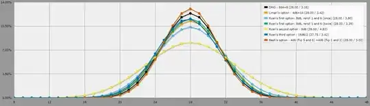

How does it compare to other answers?
I couldn't resist the urge to aggregate the various methods listed here in a single anydice link. Use comments to focus on a single potion, or display all of them - but it quickly becomes hard to read properly.
An illustration using the superior potion : superior potion comparison
It looks like this method allows the closest results to the original potions in a single roll ; but Limari's proposal will get you very close to this, with less dice and calculation. Ryan's reroll method also has very good results, even better than this one if you are ready to reroll multiple times when necessary - especially for bigger potions (e.g three times for superior).

    It's not obvious that this is intended as a solution to my problem rather than a joke. This violates the restriction of simple rules of thumb. The answer would seem more serious if you could explain how a person at the table could easily remember and compute the math. – Bloodcinder Mar 03 '19 at 12:23
    It is intended as a serious alternative, because it does not require re-rolling (which I find inelegant), does not require addition of coins or other token (which violates the the guidelines), and does not change the probability distribution in some way. It is an exact solution which is not conceptually more difficult than rolling multiple percentile dice at once. – Novak Mar 03 '19 at 17:19
  • @Bloodcinder there is an even simpler but related way, included at the end, inspired by the answer from Trish, if you can find blank dice that fit your vials. – Novak Mar 03 '19 at 18:33
  • @Bloodcinder I dislike the method, but it's a simple rule of thumb: convert two d6s to d2s and use the results as binary encodings for the d4. It's a hassle, but the rule is simple enough to qualify given your question. – DonFusili Mar 04 '19 at 13:08
  • "Hassle" and "simple" are mutually exclusive when the goal is to speed up play. I don't know of any gaming table where this method would work effectively unless all the players are math enthusiasts or deal with base conversions and encodings on a daily basis. – Bloodcinder Mar 04 '19 at 14:03
    This is essentially a d66 lookup to map to results 1-4, but if you designate one die as primary, you only need to do a lookup if the result is 5-6 and you only need the parity of the secondary die: 5 odd is 1, 5 even is 2, 6 odd is 3 and 6 even is 4. – Richard Mar 04 '19 at 14:09
  • To the mathematically-inclined, this method is (almost) as simple and straightforward as percentile rolls, and was the first thing I thought of. "But wait" the answer's tone and style might make the reader's head spin. Maybe edit for conciseness? – Tim Grant Mar 04 '19 at 18:53

To make the potions easily distinguishable visually, I would have each use one more die than the previous. Like so:
  • d6+4
    2d6+7
    3d6+18
    4d6+31
These formulas should be written on the cap of each potion.
Also, I would use spherical potion bottles with flat bottoms, so you can shake them to roll, without needing to take the cap off.

Instead of getting fancy with math or messing with standard deviations or the like, I'd take this as an opportunity for a new mechanic.
Problem: we want to emulate Nd4+N with Xd6+Y, because we don't want it to be worse for the players, and if we can use d6s we get something awesome non-mechanically.
Solution: Anything that makes it awesome mechanically.
Namely, I'd replace each 1d4+1 with 1d6. Then add the rule that when a healing potion die lands on a 1, you can choose spend a HD and get that healing as well.
These potions have the same average and are swingier, so are worse. But the option to spend HD without taking a short rest (but only sometimes) makes them quite useful.

  • Pretty sure this breaks OP's request for no swinginess "By swingy results I mean unexpectedly low or high totals or a distribution that violates conventions for how healing works in the game." – NotArch Mar 04 '19 at 19:15
