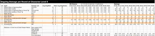

You point out that Witch Bolt is underpowered. This is true in cases where chance to hit is not a factor, but your solution would make it overpowered against harder to hit targets (high AC, invisible, hidden, etc.):
Below is a spreadsheet that calculates average damage per action of various spells (and a GWM barbarian for comparison) after the first round because the math of simulating the first round in addition to the following rounds gets a bit more complicated.
Of note:
  • It is comparable to Magic Missile, another "auto hit" level 1 spell but with the potential to do much more damage.
  • Eldritch Blast with Hex does better most of the time if you have Agonizing Blast and hex but not all characters will have access to either/both, and boosting Witch Bolt in this way renders build choices that grant access to these as irrelevant or sub optimal.
Common aDPR
