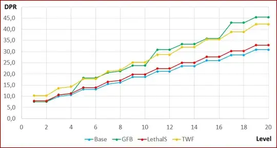

This is too weak to be a cantrip
Just like with Green Flame Blade, you can't use Two Weapon Fighting. Unlike GFB, the DPR increase is small.
Assumptions:
  • Start with Dex 16
  • Increase at levels 4 and 8
  • 65% hit chance
  • GFB's secondary damage is calculated as half1
[DPR-Level] chart, with the 3 possibilities: Two-Weapon Fighting (TWF) Green-Flame Blade (GFB) and Lethal Strike (LethalS): DPR comparison
As clearly visible from this graph, Lethal Strike is strictly weaker than simply Two-Weapon Fighting.
It can be combined with GFB, but even than it is marginal, while the combination takes up at least half of a Trickster's cantrips.
1) Spreading the damage is less effective than concentrating it on one target, and there might not even be a legit secondary target in range.
