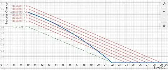

I made a graph to compare Resilient and War Caster.
How to read the graph.
The horizontal axis is the save DC, the vertical axis is the chance of success, where 1 is guaranteed success and 0 is guaranteed failure.
War Caster is blue, Resilient is red, and no-feat is green. The lines are also labeled accordingly, with the "+number" being the bonus to the save. The constitution modifier is set to 1 by default1.
There are six red lines because there are five proficiency values (2 through 6) plus another bonus if resilient improved your constitution modifier. For example, if you have 13 constitution and are advancing to level 8, then your save with Resilient would become 2 Con + 3 Prof. Therefore, you compare the blue +1 line with the red +5 line.
Resilient vs War Caster comparison.
For the purpose of concentration checks, if Resilient improves your concentration by at least 5, then Resilient is strictly better than War Caster. This is the case if your proficiency is at least 5, or if your proficiency is 4 and Resilient also improves your constitution modifier.
For the purpose of concentration checks, if Resilient improves your concentration by at most 4, then War Caster is usually (but not strictly) better than Resilient. There are a number of unusual circumstances that can skew the choice in Resilient's favor, especially if more than one applies to you. For example:
  • If you are starting at a level where War Caster would be better, but you know that the majority of the campaign will be played at levels where Resilient is better.
  • If Resilient (in combination with features such as Aura of Protection or Bladesong) would enable a concentration bonus of at least 9, because it would guarantee passing the minimum save DC.
  • If you often lose concentration by falling unconscious (rather than by failing concentration checks) and Resilient would increase your HP, because that extra HP can occasionally allow you to stay conscious and therefore concentrate.
  • If you receive damage is large chunks such that the save DC is very often over 15+Con, because beyond that threshold War Caster's benefits lessen noticeably.
  • If you very often receive damage through Constitution saving throws, because you will more often reduce these sources of damage and therefore the concentration save DC will be smaller.
  1. The graph is somewhat interactive: it has a slider called con with which you can easily change the constitution modifier.

    That graph is excellent. It does a great job showing where each feat shines. – mgillesp Aug 29 '18 at 22:20
    This is a neat toy! Is it possible to add labels to each of your lines? I was able to infer the intent of each of the red lines syncing with the the periodic bumps in proficiency, but I think it'll be improved if that's spelled out a bit more clearly. – Pyrotechnical Aug 30 '18 at 17:00
    @Pyrotechnical I added some labels and you are right, the graph is way more legible now. Though the labels overlap slightly, and the red labels become inaccurate when I increase the slider too much. – Ruse Aug 30 '18 at 18:09
  • As I read your graph, if I don't expect my character (cleric) to get past 12th level (I don't think the campaign will last that long) then War Caster looks pretty good. (Con of 16 currently). – KorvinStarmast Sep 06 '18 at 13:24
  • I feel like the last bullet point should be emphasized more. I.e. not only is improving the Con save going to help avoid damage that makes the save DC harder, it makes Con saves better. War Priest is a one-trick pony, but Resilient is going to help out in other areas; for example, you'll save more easily against being Poisoned, thus avoiding the on-going effects of that (like disadvantage for attacks and ability checks). – Peter Duniho Mar 26 '21 at 01:52
  • @PeterDuniho The question is explicitly focused on concentration checks and so in my answer I only emphasize matters related to concentration. Better con saves can lead to less damage and therefore smaller concentration checks, hence my last bullet point. The fact that Resilient is also good for other things, like ongoing effects, is off-topic so I won't add it to the answer. – Ruse Mar 26 '21 at 19:56
  • Your answer seems to ignore the benefits of wearing a shield, which War Caster almost always enables for a spellcaster. This means you will get hit less often (roughly 10% less often), which means you will need to make less concentration-constitution saving throws in general. This is "on topic" because not getting hit = maintain concentration. I would therefore recommend you add a bullet point about shields. @Ruse – Matt W Jul 24 '22 at 22:23
    @MattW: "wearing a shield, which War Caster almost always enables for a spellcaster" - "Almost always" seems a bit of a stretch. Most arcane caster classes (Sorcerer, Wizard, non-Valor Bards, non-Hexblade Warlocks, plus Arcane Trickster Rogues), don't have shield proficiency. Wildshaped Druids are concerned with maintaining concentration, but can't wield a shield while transformed. And casters who do have proficiency but either aren't typically in melee, or rely on melee cantrips instead of weapons, can wield a shield and skip the weapon with or without War Caster. – ShadowRanger Jun 14 '23 at 01:19

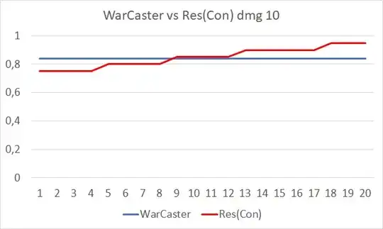

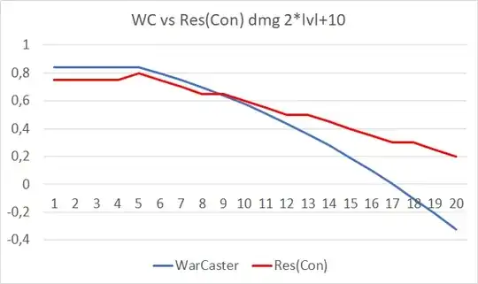

War Caster is better at the beginning, worse later
I calculated with 12 Con for War Caster, and 14 for Resilient(Con), this being an optimization question.
Once against 10 damage, this being the most common even on higher levels, once against 10 + 2 * Level (I find this a good approximation). On the Y-axis is the chance to succeed, X-axis is level.
Damage 10: dmg 10
Damage 10 + 2 * Level: enter image description here
It is visible that in both cases Resilient pulls ahead around level 9-10.
