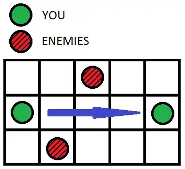

Example: Your character were cornered by two enemies in a 15 feet corridor with each of them close to the walls and your escape route is behind them and your move speed is 40 feet. You can make a Tumble check DC 15 to move at half your speed and avoid the AoO from the first enemy and another Tumble check DC 17 to avoid the AoO from the second and cross the distance safely with your move action if you succeed in both checks.
a character tumbling past two enemies, first to the character's right, then to their left.

    Nice diagram... although I must admit that as a partially color-blind tired user, I initially did not see the difference between the 4 circles. A little accessibility trick is to use different symbols, on top of different colors, for example: triangles vs squares/circles. – Matthieu M. Aug 02 '18 at 19:02
  • @MatthieuM. I've added a texture to the enemies. Does that read well? – doppelgreener Aug 02 '18 at 23:30
  • @MatthieuM. Oh, my bad. As a partially color-blinded person myself, I'm ashamed. I used colors that I can see but forgot about shapes and textures. – Aguinaldo Silvestre Aug 03 '18 at 00:03
  • @doppelgreener: Thanks for the change, immediately visible now! – Matthieu M. Aug 03 '18 at 06:18
