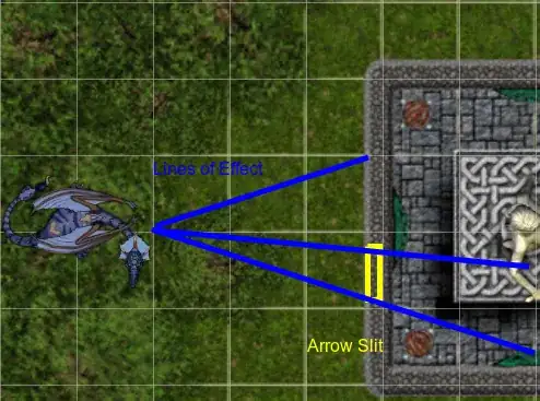

Say I cast the wall of stone spell, during or prior to combat against a white dragon, and this wall was designed with arrow slits in it for ranged attacks and cover.
How much cover would we get against the dragon's breath weapon - three-quarters cover or full cover? Or would it work like fireball, which spreads around corners?

If you create arrow slits in the wall, and are using them for ranged attacks, you have three Quarters Cover. If you made the wall with arrow slits, but no straight line exists from your enemy's space to your space that goes through the arrow slit, you will have full cover via the wall (rules for cover that support this can be found on the DMG, p. 251). Note that dragons' breath weapons don't explicitly go around corners, so full cover would be granted if you satisfy the requirements described above.

  • Example if I made the wall 40 wide and 30 high, say the arrow slit is made 10ft from the right end of the wall, I take my range attack then use my movement to move 15ft to the left behind the wall. This I would assume would be "Total Cover"?

    1.) It would if there is now no line from anywhere in the dragon's space to anywhere in your space through a slit. If there is, you have 3/4 cover. Whether or not that happens largely depends on where the dragon is relative to you/your wall. As for the arrow slits, battlements and crenulations are crudely shapeable: an arrow slit may be more refined. And more importantly, "each panel must be contiguous with at least one other panel." An arrow slit may violate this rule, depending on how you create it. 2.) I hope I've cleared that up. 3.) The dragon's position and movement will matter there. – Gandalfmeansme Jul 24 '18 at 05:16
  • okay great that does clear that up, I was mainly clarifying the cone breathe doesn't have the same affect as the fireballs spread and total cover is possible. 2. yes thank you 3. yes of course and of course it would be very situational but definitely a great option given the area wall of stone can cover.
