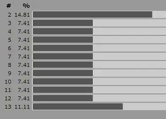

AnyDice can show you the spread of results from a "dice" with arbitrary sides. Here I have created one that gives the result of your card-draw.
AnyDice output of card-draw

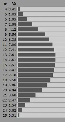

Adding in the 2d6 as well, gives this:
AnyDice output of 2d6 + card-draw

  • Would things change if a player is able to put more cards down to get larger numbers? (i.e. a 2 and a 5 to get a 7, and a 12 for their roll) up to a maximum of let's say... 5 or 6 additional cards – Jesse Cohoon Jul 24 '18 at 02:58
  • Depends on what you mean by "things". The values you'd be able to get and probabilities associated with these would obviously be different, but the shape of the distribution would be similar (a normal distribution, bell-shaped) – Boulash Jul 24 '18 at 03:38
  • Follow the second link in my answer. See the equation "2d6 + d{...}". Put a number before that second "d" to show multiple card draws. Note: these all assume replacing the card after each draw. If you draw and leave it out, the chance of getting the same number again will be less, and so the chance of getting any other number will be higher. – Adeptus Jul 24 '18 at 03:46
