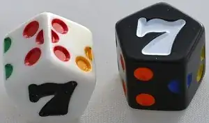

You might have come across GameScience's seven-sided die before:
This seven-sided die shaped like a pentagon, but thick, with the 1 through 5 around the five sides of the pentagon, and the 6 and 7 on the front and back faces of it.
There's mixed discussion of whether it might be biased toward the 6 and 7 faces (the 6 being on the opposite side of the 7 you can see in the photo). It's a GameScience die, and they tend to market themselves on making properly fair dice.
The only actual analysis I've found is a YouTube video, “Does a D7 (Seven-Sided Die) Roll Fairly?” posted by KingKool2099 on 24 April 2012. At 4 minutes 20 seconds they call their own results inconclusive, suggesting they may be introducing bias in their rolling method. (They found bias toward 6 and 7, but also toward the 2 which is on an edge.)
Has there been any decently conclusive analysis of whether this die is a fair die? Has there been a mathematical analysis, one where someone put it through a dice tower?

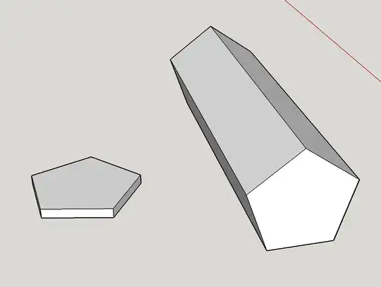

It's possible to have a fair d7 in specific scenarios
First, it is definitely theoretically possible to have a seven-sided die. The die as shown is a pentagonal prism. Geometrically, the die's fairness is most strongly affected by the size ratio of the pentagonal faces to the rectangular sides. I've made a quick mock-up of the two extremes:
  • Faces are larger than sides: This corresponds to the shape on the left side. This extreme strongly favors the pentagonal faces--it's basically a coin, and it's difficult to imagine it ever landing on the edges.
  • Sides are larger than the Faces: This corresponds to the shape on the right. In this case, the die is more like a pencil, and will almost always fall on the sides.
As one smoothly adjusts the size ratio between the sides and the faces, there will be a specific point where there is a transition between favoring the sides and favoring the faces. This intercept is the point at which the die is fair. Therefore, it is possible to have a fair 7-sided die.
However, this magic ratio might not be the same for all conditions. This answer on MathOverflow argues that for non-isohedral die, the fairness of the result depends on how you throw it. Likewise, this random page on the internet claims that different surfaces might affect the outcome of the roll. Neither source provides hard evidence for their claims, but it's worth considering that the intermediate value argument presented above does not prove that a single d7 can be fair under all conditions.

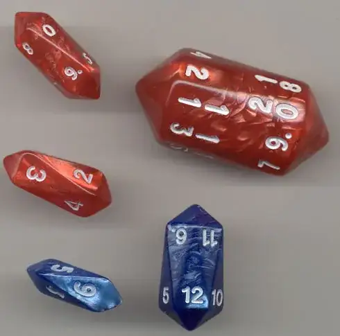

Making fair dice by ignoring faces
Dice with an odd number of flat faces can be made as "long dice".[26] They are based on an infinite set of prisms. All the (rectangular) faces they may actually land on are congruent, so they are equally fair. (The other 2 sides of the prism are rounded or capped with a pyramid, designed so that the die never actually rests on those faces) Source
That last sentence is the most important part. This 7 sided die is fair for ranges 1-5, provided you ignore the 6 and 7th face. As we read above, any prism can be fair provided the ends are "capped" or ignored (see Long Dice). So, a real d7 would be made of a heptagonal prism. So, ignoring the ends, there exists a rotation that maps every face, vertex, and edge onto the location of a different face, edge, and vertex. Lets go back to that example above. We lay it flat on the 6th edge and spin it 72 degrees. Voila! Each of the faces is now in the location of where a face used to be, each edge is in the place of where a different edge was, and each vertex is in the place of a different vertex. Except for the caps, which we've ignored.
More recently, you may have noticed barrel dice. They use the same basic principle, except their sides are triangles rather than rectangles.
