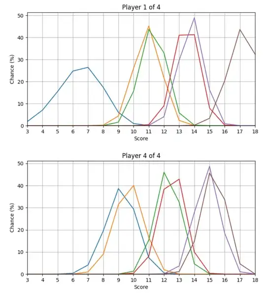

Exact distributions for first and last player
Here are graphs of the distribution of the highest, 2nd highest, ... score for the first and last players out of 4. Note that the curves aren't independent; in particular, the first and last players are likely to have pairs of the same number when they take two picks in a row.
Exact distribution for first and last player
Commentary
As with the other answers here, I'd say the first player has the most advantageous position, since a high top score tends to help more than a low bottom score hurts. I like OP's commented idea of flipping the 3rd round against the first player, so the first player only gets the highest score in the 1st and 5th rounds.
Algorithm
This was computed using my hdroller Python (heh, "snake draft") library, which uses combinatorics and dynamic programming to find the exact result in just seconds. You can try this computation (including tables of mean arrays for 1-6 players) in your browser using this JupyterLite notebook.
