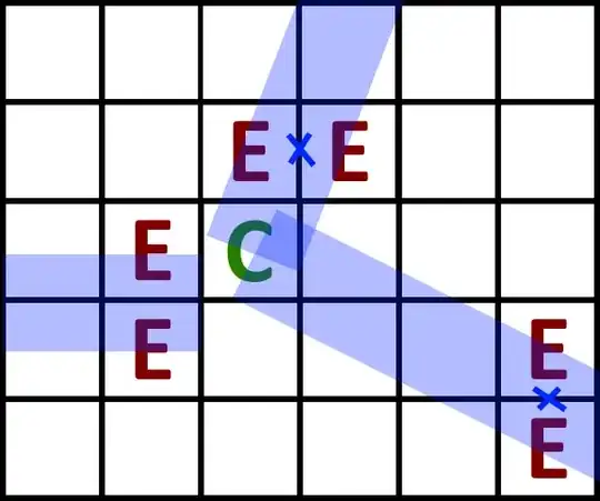

If you target the center of the edge between the two squares you want to hit, both squares are covered exactly half, so both are effected.
It does not matter if you start the line from the center or the corner (C: Caster, E: Enemy).
