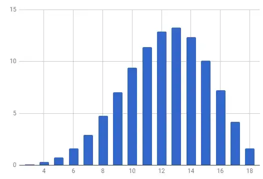

Here is a graph of the distribution for 4d6 drop lowest (Mean = 12.24, Standard Deviation = 2.85)
Take particular notice of the extreme rarity of 3, 4, and 5 values. The best way to accommodate this is to give values below the mean their own point system. Essentially there will be two parallel point systems. The basic weight of the point costs will roughly compare to the number of discrete rolls away from the medians (of 4,4,4,2... among others).
