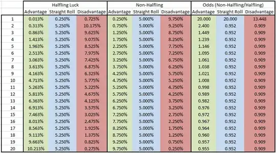

Probabilities for exact rolls
The values below show the chances for each roll to occur exactly. I also added in straight roll calculations to provide a comparison, and color-coded the matching columns.
The column showing the odds simply show a ratio of two probabilities. In this case, the Non-Halfling probability divided by the Halfling probability shows how much more likely you are to roll exactly \$x\$ when you are not a halfling.
In general, you are more likely to roll the lower values when not a halfling, but not by much. The exceptions are for rolling 1's (you are really not likely to roll them) and rolling 2 through 5 if with advantage. But otherwise, the odds are generally within 0.9 to 1.1, so there is not a very large effect.
PDF
Probabilities for cumulative rolls
The values below show the chances for each roll to occur cumulatively -- ie, the row for Roll = 4 shows the chances of getting at least a 4 in the different scenarios. I also added in straight roll calculations to provide a comparison, and a column on odds.
CDF
Solution

Now that we have all the formulas of \$x\$ for any value of the d20, we can tabulate them. All values below are exact values.
\begin{array}{|c|c|} \hline \text{Roll} & \text{Advantage} & \text{Straight Roll} & \text{Disadvantage} \\ \hline 1 & 0.0125\% & 0.25\% & 0.725\% \\ \hline 2 & 0.3125\% & 5.25\% & 10.175\% \\ \hline 3 & 0.8625\% & 5.25\% & 9.625\% \\ \hline 4 & 1.4125\% & 5.25\% & 9.075\% \\ \hline 5 & 1.9625\% & 5.25\% & 8.525\% \\ \hline 6 & 2.5125\% & 5.25\% & 7.975\% \\ \hline 7 & 3.0625\% & 5.25\% & 7.425\% \\ \hline 8 & 3.6125\% & 5.25\% & 6.875\% \\ \hline 9 & 4.1625\% & 5.25\% & 6.325\% \\ \hline 10 & 4.7125\% & 5.25\% & 5.775\% \\ \hline 11 & 5.2625\% & 5.25\% & 5.225\% \\ \hline 12 & 5.8125\% & 5.25\% & 4.675\% \\ \hline 13 & 6.3625\% & 5.25\% & 4.125\% \\ \hline 14 & 6.9125\% & 5.25\% & 3.575\% \\ \hline 15 & 7.4625\% & 5.25\% & 3.025\% \\ \hline 16 & 8.0125\% & 5.25\% & 2.475\% \\ \hline 17 & 8.5625\% & 5.25\% & 1.925\% \\ \hline 18 & 9.1125\% & 5.25\% & 1.375\% \\ \hline 19 & 9.6625\% & 5.25\% & 0.825\% \\ \hline 20 & 10.2125\% & 5.25\% & 0.275\% \\ \hline \end{array}
And the cumulative distribution to roll at least \$x\$. All values below are exact values.
\begin{array}{|c|c|} \hline & \text{Advantage} & \text{Straight Roll} & \text{Disadvantage} \\ \hline 1 & 1 & 1 & 1 \\ \hline 2 & 0.999875 & 0.9975 & 0.99275 \\ \hline 3 & 0.99675 & 0.945 & 0.891 \\ \hline 4 & 0.988125 & 0.8925 & 0.79475 \\ \hline 5 & 0.974 & 0.84 & 0.704 \\ \hline 6 & 0.954375 & 0.7875 & 0.61875 \\ \hline 7 & 0.92925 & 0.735 & 0.539 \\ \hline 8 & 0.898625 & 0.6825 & 0.46475 \\ \hline 9 & 0.8625 & 0.63 & 0.396 \\ \hline 10 & 0.820875 & 0.5775 & 0.33275 \\ \hline 11 & 0.77375 & 0.525 & 0.275 \\ \hline 12 & 0.721125 & 0.4725 & 0.22275 \\ \hline 13 & 0.663 & 0.42 & 0.176 \\ \hline 14 & 0.599375 & 0.3675 & 0.13475 \\ \hline 15 & 0.53025 & 0.315 & 0.099 \\ \hline 16 & 0.455625 & 0.2625 & 0.06875 \\ \hline 17 & 0.3755 & 0.21 & 0.044 \\ \hline 18 & 0.289875 & 0.1575 & 0.02475 \\ \hline 19 & 0.19875 & 0.105 & 0.011 \\ \hline 20 & 0.102125 & 0.0525 & 0.00275 \\ \hline \end{array}

print(&quot;~~~~~Normal Rolls~~~~~&quot;)
print()
print(&quot;Total number of rolls: %d&quot; % end)
print(&quot;Total number of rerolls: %d&quot; % numberofrerolls)
print(&quot;Percentage of rerolls compared to total number of rolls:&quot;)
print(numberofrerolls / end)
print(&quot;Average value of a die across all rolls without Halfling Luck:&quot;)
print(average / end)
print(&quot;Average value of a die across all rolls with Halfling Luck:&quot;)
print(averagereroll / end)
print(&quot;Difference of values: &quot;)
print((averagereroll / end) - (average / end))
# Advantage/Disadvantage rolls
disadvantage = np.zeros(20)
disadvantagewithrerolls = np.zeros(20)
numberofrerolls = 0
averagea = 0
averaged = 0
averagear = 0
averagedr = 0
for i in range(0, end):
    x = randint(1, 20)
    y = randint(1, 20)
    if x is 1 and y is 1:
        z = randint(1, 20)
        numberofrerolls = numberofrerolls + 1
        disadvantagewithrerolls[x - 1] = disadvantagewithrerolls[x - 1] + 1
        advantagewithrerolls[z - 1] = advantagewithrerolls[z - 1] + 1
        disadvantage[x - 1] = disadvantage[x - 1] + 1
        advantage[x - 1] = advantage[x - 1] + 1
    else:
        if x is y:
            advantagewithrerolls[x - 1] = advantagewithrerolls[x - 1] + 1
        elif x is 1:
            z = randint(1, 20)
            if z &gt; y:
                disadvantagewithrerolls[y - 1] = disadvantagewithrerolls[y - 1] + 1
            else:
                advantagewithrerolls[y - 1] = advantagewithrerolls[y - 1] + 1
                disadvantagewithrerolls[z - 1] = disadvantagewithrerolls[z - 1] + 1
            advantage[y - 1] = advantage[y - 1] + 1
        elif y is 1:
            z = randint(1, 20)
            if z &gt; x:
            else:
            disadvantage[y - 1] = disadvantage[y - 1] + 1
        elif x &lt; y:
        else:
for q in range(1, 21):
    averaged = averaged + (q * disadvantage[q - 1])
    averagea = averagea + (q * advantage[q - 1])
    averagedr = averagedr + (q * disadvantagewithrerolls[q - 1])
    averagear = averagear + (q * advantagewithrerolls[q - 1])
d = averaged / end
dr = averagedr / end
a = averagea / end
ar = averagear / end
print()
print(&quot;~~~~~Advantage/Disadvantage Rolls~~~~~&quot;)
print()
print(&quot;Total number of pairs rolled: %d&quot; % end)
print(&quot;Total number of die rolls (pairs plus rerolls): %d&quot; % (numberofrerolls + end))
print(&quot;Percentage of rerolls compared to total number of pairs rolled:&quot;)
print(&quot;Average value of a disadvantage die across all pairs rolled without Halfling Luck:&quot;)
print(d)
print(&quot;Average value of a disadvantage die across all pairs rolled with Halfling Luck:&quot;)
print(dr)
print(&quot;Average value of an advantage die across all pairs rolled without Halfling Luck:&quot;)
print(a)
print(&quot;Average value of an advantage die across all pairs rolled with Halfling Luck:&quot;)
print(ar)
print(&quot;Difference of values between disadvantage dice values with Halfling Luck vs without Halfling Luck: &quot;)
print(dr - d)
print(&quot;Difference of values between advantage dice values with Halfling Luck vs without Halfling Luck: &quot;)
print(ar - a)
</code></pre>
<p>A trait that allows you to reroll a die, at least some of the time, is, in my opinion, always a good thing to have, although on average the results are not drastic. Rerolling a guaranteed failure and getting a successful result makes for great roleplaying though.</p>
