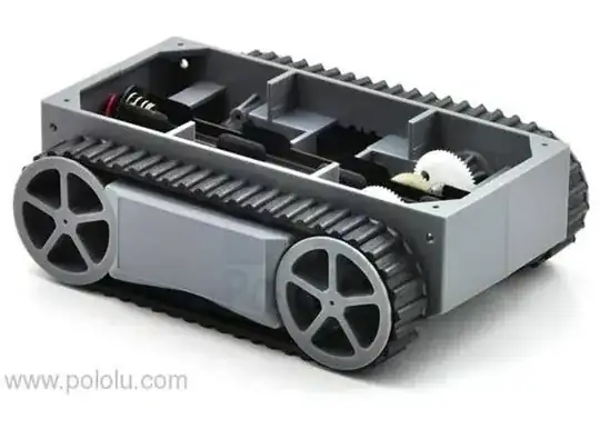

I have the following chassis along with an Arduino and a motor shield. Robot Chassis
I'm in the process of developing a tracking mechanism for use with differential drive.
Normally, a photo reflector can be placed adjacent to the wheel that will reflect when each spoke passes through therefore allowing code to be written that will accurately measure each wheels position.
The problem I have is that you cannot see the wheels from inside the chassis, only small holes for the driveshaft. Placing sensors on the outside would look ridiculous and a wall crash would cause havoc.
Would I be able to use a photo reflector on the gears (as shown) if I accurately placed it to count each spoke on the gear itself? I'm a bit hesitant though because even a small bump could misalign the sensor - again causing havoc.
So does any one have an idea on how to track the wheel movements?

I put together encoders for this exact chassis. Rather than reflecting ones, I used slot ones. I thought I could work off the hole in the white gear, but it turns out the plastic is pretty transparent to IR, so I ended up using some black electical tape (high tech, I know) to make opaque regions on the gear.

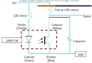

I ended up using Vishay transmissive optical sensors (model TCST1202) I purchased from DigiKey. I wired them up based on the circuit posted by Aniss1001 in the “Homemade wheel encoder“ thread on the Arduino forum.
Encoder circuit diagram - for a different encoder, but it worked fine

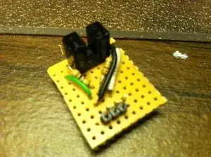

I built the circuit on a prototyping breadboard for testing and got a surprise. The circuit worked fine, but the gear is transparent to IR! It turns out that nylon and most plastics used for inexpensive gears are pretty transparent to IR. I first tried creating an opaque section with a black marker, but while that worked on paper, it didn’t adhere well enough to the gear. I ended up using a piece of black tape. Once that worked, I cut some small circuit boards down to size and built the encoders, practicing my soldering skills.

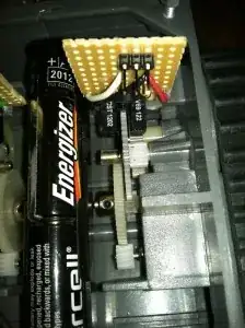

I just used hot glue to mount the encoders. The encoder boards stick up above the chassis base, so I’m using standoffs to raise the plastic plate with the Romeo controller and other devices. Here’s a picture of one of the encoders before mounting,, and then mounted on the chassis:
Mounted encoder

Are the wheels essentially hollow except for the spokes? If they were, it would seem to me like adding a small hole a little offset from the front axle (the wheel without gears) would be a good place to put a light detector. Of course that would not work too well in the dark.
Each spoke, or more properly tooth on the gear, while technically would be correct, as you indicated may be hard to accomplish due to size.
Does the non-gear wheels axle come into the chassis? Could you add an optical encoder there? Possibly by making the axle fixed to the wheel but pass through some sort of bearing.
I've never experimented with odometry with tracks, but I assume due to their increased slippage, you will have to deal with greater errors than plain wheels during turns. Have you considered that?
In any case, I think you are going to have to do some 'customization' to get what you want.
I could not find that chassis at Pololu. Is it an older model?
Ah I see now where it has been replaced. The newer chassis has encoders as an option.
