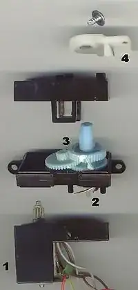

The reason why your RC servo's are hard to turn is that they have a high ratio gear train to give them the torque they need, and this makes them difficult to backdrive. Take a look at this exploded diagram from the wikipedia Servomechanism page:
Exploded RC servo - This work has been released into the public domain by its author, Sonett72 at the wikipedia project. Small R/C servo mechanism
  1. electric motor
  2. position feedback potentiometer
  3. reduction gear
  4. actuator arm
A small turn of the actuator shaft of this RC servo would result in a large (many turn) movement of the motor, if you could get it to move without stripping the gears.
Again, since in your application you only need enough torque to turn the knob, you may be able to get rid of that gearing and use the motor position directly. By removing or reducing the gearing, you should find the motor moves very freely indeed. In fact, you may need to add some friction (or leave some gearing in place) in order to prevent the motor being very jittery.
