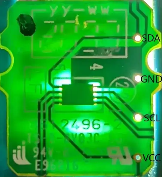

I found that user to have the most information (which overall isn't a lot but more useful than anything on the Internet and nothing more has been posted since then! As of December 2021). For mine the context is for Brother DCP-L2550DW for toner TN-760 or TN-730. Rather than TN227 or TN223. I followed the same format and made similar assumptions. Based on their discovery, I sort of just put my hypotheses here for SDA, GND, SCL, VCC (literally what the previous discussion Answer #1 stated as their guesswork and for whom 1 responder said it was correct for them?). I'm no engineer, so I had to just make analogous assumptions. For communication’s sake I put 1, 2, 3, and 4 for Pad 1, Pad 2, Pad 3, and Pad 4.
I'm using IC2 Scanner program and running it in Arduino using ELEGOO UNO R3. The problem is that when I physically connect to the configuration and any combination thereof and run the code (or “serial monitor”) the output stops. While I'm still physically holding the pins to the “pads” on the microchip (i.e. the FOUR fat rectangular contacts) the code is at a blank or just “writing”. Upon release of the pins, it spews out gibberish, which I assume is the tested address for IC2. I know I'm doing something wrong.
My assumption based on the previous forum is that GROUND is 2 and VCC is 4. I have mixed all other combos to no avail. I strongly feel there is a noob mistake I'm doing.

Update: I have resigned to finding manufacturer. But I wanted to make one last point. Here is image of the previous forum (linked on top) side-by-side with my picture. One of the hidden commenters (5th responder) below on that discussion confirmed they were successful based on the hypothesus of the first commenter. And if that is true I noticed similarity in design as far as the circuitry on mine and the other original poster. And if THAT is true and the supposed circuitry is correct then possibly I have more of a software issue on the I2C scanner software. And I also don't know if mine is 5 volts or 3.3 volts (but I really want to say it would be 3.3 volts bc of my unscientific hunch). I would have to invest in a "logic analyzer" which is where I might suspend activity for now since that is another rabbit hole. I added a link to a DIY Youtuber who is also not a professional engineer but who did a fantastic job explaining what he knew. In the comment section (gotta dig a little deep but not too longer) there is a reference for the I2C scan code to READ the chip. Under his guidance it supposedly is able to scan for the address but that's assuming one knows the circuitry of the EEPROM. Without knowing that step its just plain hard to continue. I included it to show what code I was using for my arduino UNO R3 which is producing the same results with the proposed configuration as when I don't touch the wires to anything (i.e. serial output runs address gibberish when I touch nothing on the other end).
Side by side comparison of the two EEPROMS, original of which had confirmation of successful result. I had no luck. Side by side comparison of the two EEPROMS

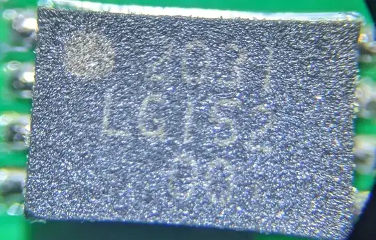

Also, here is the EEPROM under a microscope: enter image description here enter image description here

  • Does anyone know what EEPROM this is? I think it says "2031.. LC 153.. 00" on it. And does anyone know who might be the manufacturer? Once I know that I should be able follow through and read and write to it. – G. L. Dec 09 '21 at 19:58
  • The manufacturer remains unknown. The only step that can be done is to use a logic analyzer. Those don't come cheap. My next piece would be to work out logic analyzer w/ arduino Uno R3 but that's another rabbit hole. Or take wild guesses (4 factorial?). Also, I am running IC2 Reader that supposedly will test for address. I keep getting outputs for the addresses that aren't quite right (noob mistake?). It has "write" and "read" 128 bytes with no meaningful output. Same output even when I don't plug in the pins so any combination of pins has same output as if i put the contacts in mid-air. – G. L. Dec 27 '21 at 09:24

If it is still interesting for someone- the pads are: SDA, GND, SCL, VCC(~3V)maybe standard 3.2v; from left to right in front of printer/or as seen connector inside. The VCC is not constant, starting point at 0 on the scope: first pulse is 45ms, second - on the 60ms point, third- on the 75ms, fourth - on the 135ms point and all next 20ms one after another. All except first are short only around 1-2ms exactly to read 2 packets of data. The reading pulses are more than 20. It is difficult with scope to get communication, but if someone try to write program to read the board in this sequence I think it will be success.
