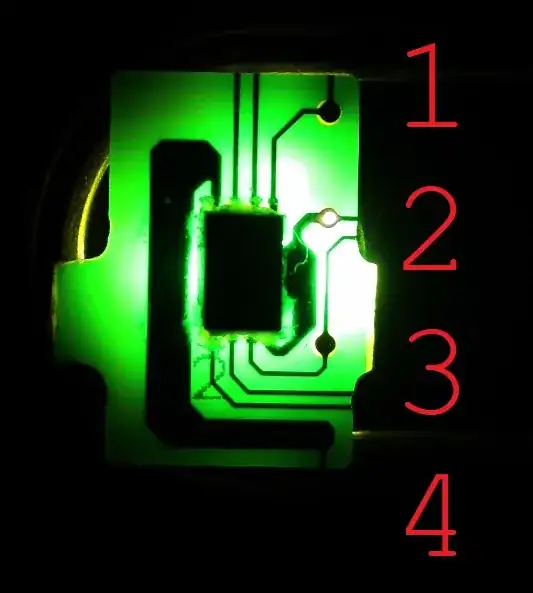

Here are some pictures of the starter TN223 chip that my printer came with:
Pads of chip with numbers I added
Back of Chip
Light shining through chip
The pictures are shown as following:
  • Pads of chip with numbers I added
  • Back of Chip
  • Light shining through chip
I then opened the printer to determine which pins go to what. I first used a multi-meter to determine that pads 2,3,4 are shorted to each other on each chip for each color C, Y, M, BK. I then found pad 2 was shorted to the printer frame, so I assumed that was ground. Then I looked at the wiring color. It's matched as the following:

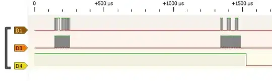

I then connected a logic analyzer to the printer with the chip attached to see if I could figure out what protocol it was using. Assuming white is GND, Here's a sample of the Sigrok Pulseview received:
sample data assuming pad 2 is ground
zoomed in on start of data
I ran the test twice and attached the Sigrok file results here and here.
These can be opened in Pulseview (free program) for a graphical representation of the data
It appears that the data is only sending when pad 4 goes high, I assume this is VCC. I then measured the voltage from pad 4 when communication occurs using an arduino and measured 3.3V. I now assume the chip is using 3.3V logic.
I still don't know if the pad 2 is GND since pad 3 is black which usually indicated ground, however as previously stated pad 2 is shorted to the frame of the printer. I then attempted to connect pad 3 as GND to my logic analyzer and connect pad 2 as not ground, however something strange occurred, and the printer no longer accepted the cartridge I was messing around with. Going back to pad 2 as ground, and it started working again. I'm now assuming pad 2 is ground.
When investigating the data further, there seems to be a little difference between two runs. I simply turned the printer on and recorded data then immediately turned it off then back on to get my second run, however the data seemed to change slightly. To ensure it wasn't due to sampling error, I increased the sampling to 20 MHz, which includes about 20 samples per clock cycle which should be sufficient to measure the wave forms consistently. When measuring the clock rate, I found it to be between 432-457Khz.

    I'm guessing it's I2C and D3 is SCL, D1 SDA, and D4 VCC – Avery3R Mar 07 '19 at 02:56
  • The issue I have with I2C is that my data line is normally low as compared to normal I2C which is normally high, also I can't identify a start condition since both the clock and data line go high at the same time. I added an image showing the start of the data above. – benjinne Apr 04 '19 at 12:54
