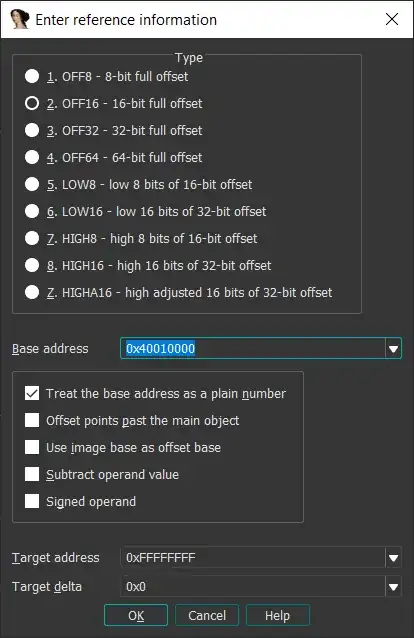

EDIT: Actually IDA does it in some cases. PowerPC processor module seems to know about __init_registers() function when working with ELF files and uses r13 value to calculate the global variables offsets relative to r13. enter image description here
And I've learned that it actually creates User defined offsets in such cases.
But still don't know how it's implemented to know r13 value.
