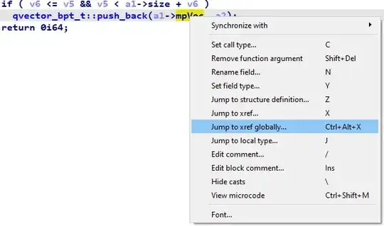

In IDA 7.4 and above (I think; might have been 7.3), right-click the variable and press "Jump to xref globally", as follows:

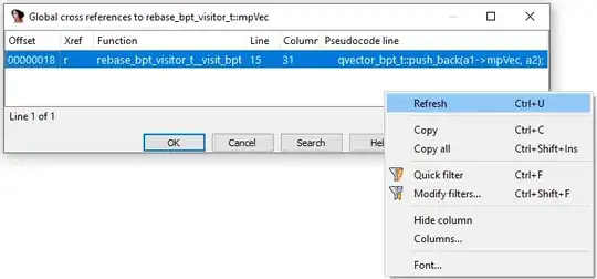

You'll get a popup with all global x-refs, as follows:
Global cross references
This is based on caching, so the first time you do it, you'll want to right-click and press "refresh" as in the image above (which will take a while for large databases, but is totally worth it -- this is one of my most frequently-used features in Hex-Rays).
