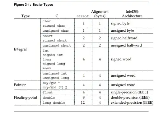

Alignment of variables depends on their type and the architecture of the CPU. This is also specified in the ABI: Fundamental types, i386
There are conventions that pertain specifically to the alignment of arrays, structures and unions:
Aggregates (structures and arrays) and unions assume the alignment of their most strictly aligned component. The size of any object, including aggregates and unions, is always a multiple of the object’s alignment. An array uses the same alignment as its elements. Structure and union objects can require padding to meet size and alignment constraints. The contents of any padding is undefined.
