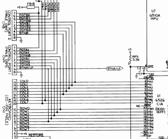

To deal with this well it's important to understand the schematic on page 12 of the service manual, and the keyboard matrix. (The keyboard matrix diagram in the service manual is incomplete.)
To get the information we need from the schematic, you don't need to understand anything special about electronics beyond switches and wires being connected together. We see below, for example, that pin PA1 on the CIA, COL1 on the keyboard connector, and JOYB1 on control port 2 are all connected together; all of these are part of the "COL1 line."
C64 joystick/keyboard schematic
The joystick and keyboard wiring itself is not shown on the above diagram. Joysticks connected to the control ports have normally-open switches that short to ground when closed; e.g., pushing up on a joystick connected to port 1 would short pin 1 to pin 8 on the joystick connector, thus bringing the level of the ROW0 low. The keyboard keys connect COL0-7 lines to ROW0-7 lines as described in more detail below.
The core concept is that you have a set of sixteen lines, COL0-7 on CIA pins PA0-7 and ROW0-7 on CIA pins PB0-7, each of which will have a high or low level you can read.
The lines default to high when nothing connects them to ground; this is done by pull-ups in the CIA. But if any of these lines are connected to ground, via a keyboard or joystick switch or a setting both DDR=1 and PR=0 in the CIA itself, the line will be at low level, always overriding both the default pull-up to high and any CIA setting of DDR=1,PR=1 for that pin.
There may be multiple connections to ground, making this a "wired-OR" system: any one of these connections, if made to ground, will force the line low regardless of how any other connection is set. In other words, it's not possible for the line to be high if anything on that line wants to bring it low.
There are three basic ways a line can be brought low:
  1. A joystick switch, connected directly to ground, is closed.
  2. A keyboard switch is closed and one of its two lines (COLn or ROWn) is low, bringing the other line low.
  3. The CIA has been programmed to bring the line low by setting its bit in DDR to 1 and setting its bit in the PR to 0. Any other setting will not drive the line low (at least not by the CIA). In particular, setting both DDR and PR to 1 will not necessarily drive the line high; it will just leave it at whatever value is a consequence of other settings (high by default, or low if anything else connects it to ground).
The wiring for the joysticks is the simplest: each switch (left, right, up, down and fire button), when closed, brings low the line to which it's connected (COL0-4 for joystick port 2 and ROW0-4 for joystick port 1.)

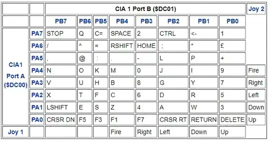

The keyboard is slightly more complex. With the exception of the RESTORE key (which is handled completely separately by means other than the CIA), each key connects one COL line and one ROW line together when pressed, as in a matrix switch. Here's the matrix diagram from my link above:
Comodore 64 keyboard matrix
Thus, pressing a key will do do nothing at all unless something (hopefully you, by programming the CIA) has brought at least one COLn or ROWn line low, in which case a read will show corresponding ROWn or COLn lines as low for any pressed keys connecting the two. This includes the situation described in your link Scanning the Keyboard the correct and non-KERNAL way where the path goes through multiple keys, e.g., grounding COL2 and pressing A and S to give a path COL2→A→ROW1→S→COL5 that brings COL5 low.)
When scanning the keyboard, there's no particular reason as far as I know to choose to force COLn lines low and read the ROWn lines or vice versa. In fact, doing it both ways might even help you to do more reliable reads. (I provide a example of this below.)
