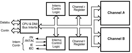

I think the canonical example from the 16-bit era is the two ports on the Macintosh provided by a single Zilog 8530 and able to be used for serial, printer, modem, and AppleTalk networking based on user configuration. Of course this was influenced by the modem and printer port on the 8-bit Apple //c, but those ports relied on 2 independent 6551 UARTs.
In order to actually answer the question, which stipulated a single controller chip on an 8-bit microcomputer system, I'd point out the Apple IIgs as a possible answer. It shared the single Zilog "Serial Communications Controller" ("SCC") architecture with the Classic Macintosh, while also being compatible with the two independent serial ports approach of the earlier Apple //c. The two ports on the Apple IIgs support AppleTalk, printers, modems, and other serial connections, in much the same manner as the Mac when used under GS/OS. When used in ProDOS 8, the two ports mimic the behavior of the Apple //c ports. It's quite flexible and a real testament to the power of Zilog's SCC compared to vanilla UART controllers.
From the Zilog Users' Manual:
  • Two independent full-duplex channels
  • Synchronous/Isosynchronous data rates up to 5 Mbits/sec
  • Asynchronous
  • Byte-oriented synchronous
  • SDLC/HDLC
  • Receiver FIFO
8530 block diagram
Since the SCC manages all the multiplexing internally, it is exceptionally easy to implement from a hardware standpoint. Naturally, the software has to fill in the gap of managing the added complexity of two channels and multiple operating modes. This software control was done quite well on the IIgs.
