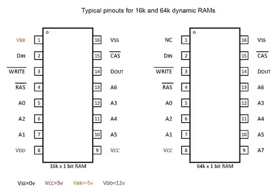

The 4116 and 4164 have different pin allocations for the reason you'd expect: the 4164 has an additional address line (for two more bits of address in total because row and column are multiplexed). So you can't just drop one in, in place of the other. The 4116 also receives a 12v signal, which the 4164 doesn't. So you can't perform a straight substitution.
If you want to hack in 64kb where no original provision was provided, you'll need to make sure you don't connect that 12v signaland implement some sort of paging scheme of your own, to buffer an additional two bits and provide either one upon RAS and CAS. Or a single bit to supply regardless of RAS and CAS, to give 32kb in a 16kb slot.
So that means cutting or bending pins 8 and 9, connecting 8 to the board where 9 was, and providing a different input for 9.

    And the different input for pin 9 is the hard part. Remember that this pin has two address lines multiplexed onto it, so you're going to need to detect when the main board logic is producing the RAS and CAS signals in order to choose which of your two extra bits of address you want to give it. As pointed out, in a machine not designed for 64K there's probably no unused address lines coming out of the processor, so you're going to need to implement some kind of paging scheme. – Jules Dec 26 '17 at 22:58
