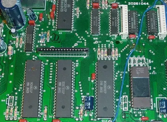

The Tandy Color Computer 2 could be upgraded from 16k to 64k by simply swapping chips and adding a jumper.
Early revisions used eight 16k x 1 bit or 64k x 1 bit DRAMs. The 16k chips were type MCM4517 or 2118, which only require a +5V power supply (unlike the 4116 which needs +12V, +5V and -5V).
Later revisions used two 16k x 4 bit or 64k x 4 bit DRAMs. Here is my CoCo2 upgraded from 16k to 64k. The two 64k x 4 DRAMs are in the upper right area (between the 2 white sockets intended to take a 64k daughter board), and the 64k 'RAM SIZE' jumper is in the lower left corner.
